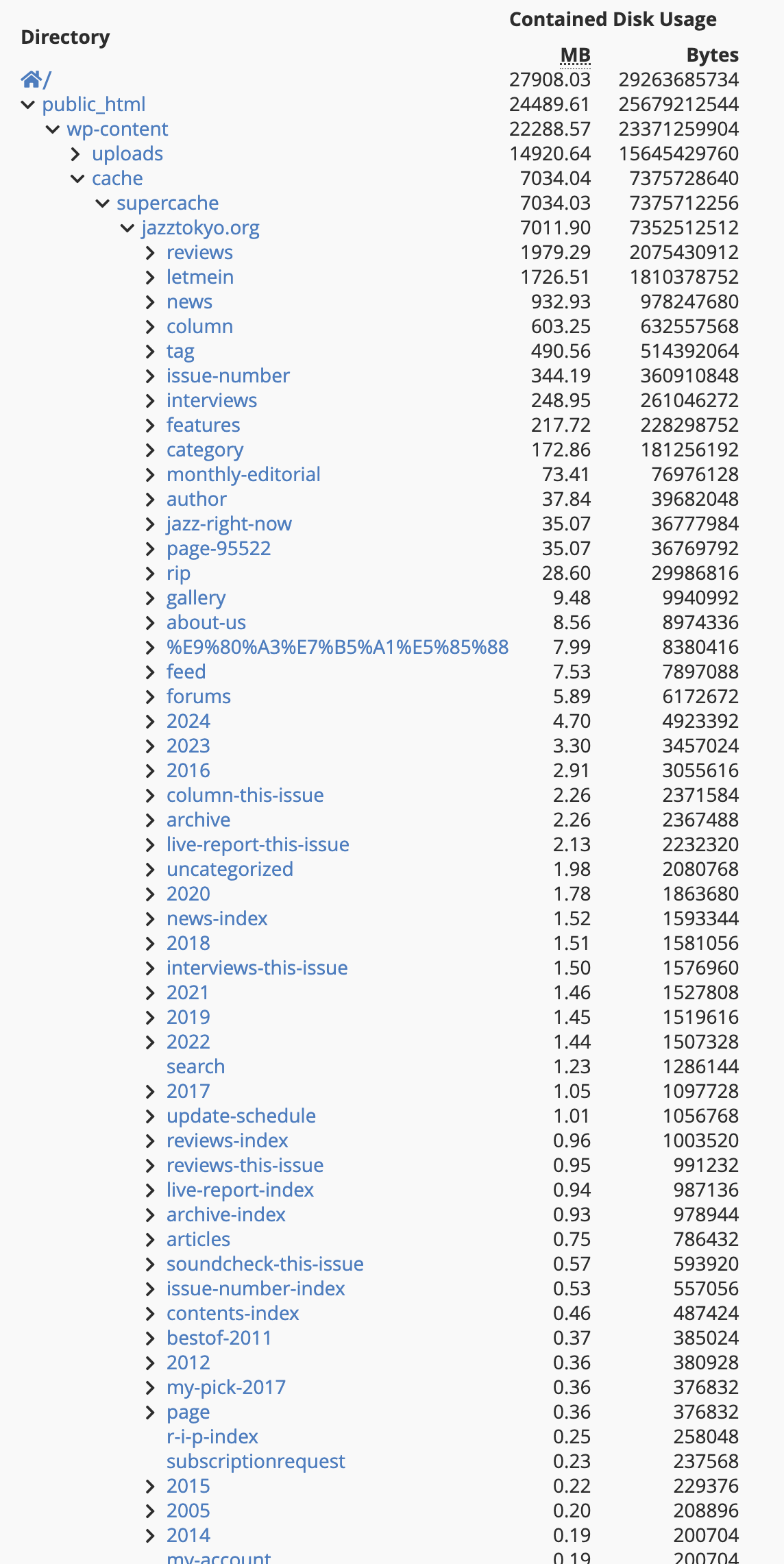

    Thank you for your response. I am not sure how to figure this out. As far as I can see, there isn’t anything suspicious. They are HTML files, and tons of them. What’s puzzling is that these are dated articles, and I don’t think they are frequently accessed files.
    Screenshot
    I do have WP Control installed but I was not sure if I know how to use it. I just took a look at it, and found ‘wp_cache_gc’ scheduling is set to “Do Not Repeat”. Do I need to change this? Still wondering why this issue surfaced only a couple of months ago. Thank you for your help.

    Is the garbage collection still set to 3600/600? Can you manually clear out the cache, and check the cache directory to make sure everything (or at least, most of everything) was deleted.
    Then wait 60-70 minutes and look in the cache directory again and check if things were deleted.
    If, after only an hour, the contents of the directory is huge again, it might be worth changing the garbage collection to 600/60 or maybe even 300/60 so files are deleted more quickly.
    If it looks like no files have been deleted, it might be a problem with PHP deleting so many files and timing out. 7034MB of files is excessive, if your GC is set to 3600/600. Reducing the time limit should help there.

    I changed to 600/60 last night. The cache size is 500MB overnight. They are all html, and not gz nor random string in any file names.
