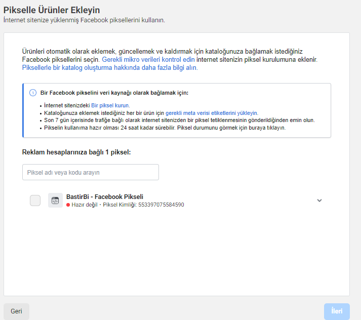

    Hi @dafnex35 – would you be able to temporarily switch your site language to English, and repost your screenshots?
    Thanks in advance!
    Thread Starter dafnex35
    (@dafnex35)
    Even though I made the link, it is blank, the pixel does not appear on the site automatically. Products are not added automatically.
    https://i.hizliresim.com/3t1l3wc.jpg

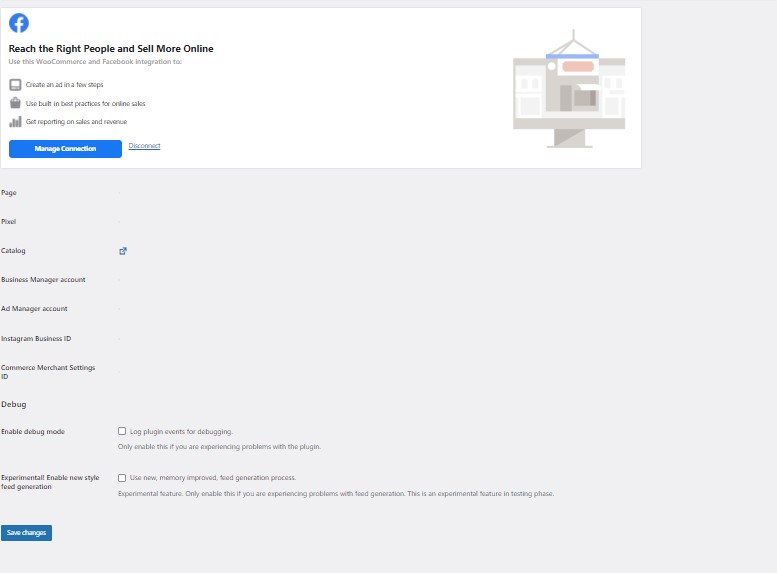

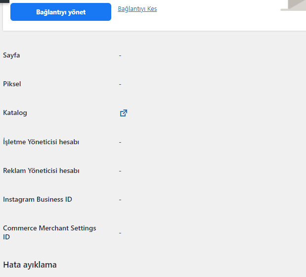

    Hello @dafnex35
    Thanks for changing the language and sharing the screenshot of what you are seeing. Can you enable the debug mode for the plugin and test again, please? This will create logs in the site that could show more about what’s going on.
    https://d.pr/05sl0u
    Once you’ve tested this please check the logs in your store settings at WooCommerce → Status → Logs tab. Open the drop down menu and select the most recent log for Facebook and click the ‘View’ button to load it. I also recommend looking for any ‘fatal-error’ logs. Those could show more information about what’s occurring.
    If you find any relevant logs please share them here. But be sure to obscure any private customer and/or store information before submitting. I hope this helps!

    @mother.of.code.a11n
    I tried many times, same result. pixel does not appear on the site…
    Before ssl certificate it was working fine… After ssl, the problem of not adding products started. I uninstalled and reinstalled the apps. the result is the same. i can’t figure it out…
    product add screen pixel not ready error
    https://i.hizliresim.com/kzblqaf.png
