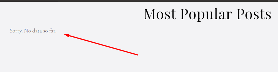

    However, whenever I put post_html parameter, it suddenly says, “Sorry, No data so far.”
    But without the post_html parameter, the data shows up fine.
    Is there something wrong with my shortcode?
    [wpp range="all" order_by="comments" stats_comments="1" post_type="photoset,scratching,issue" stats_views="0" stats_author="1" post_html="<li>{thumb} <a href="{url}">{text_title}</a></li>"]
    I haven’t experimented on the post_html parameters. I just tried the example given to see if it works, however whenever I put the said post_html parameter, the page says, “Sorry, No data so far.”

    Thread Starter anneyu
    (@anneyu)
    Hi @hcabrera,
    That didn’t do the trick, unfortunately 🙁
    Here’s the shortcode I’ve put:
    https://i.ibb.co/9YXCLxm/Annotation-2020-04-30-215907.jpg
    Here’s the result:
    https://i.ibb.co/cgpxFyy/Screenshot-14.png
    And yet again, once I remove the post_html parameter, the code works.
    Any ideas? Where did I go wrong this time?
    Plugin Author Hector Cabrera
    (@hcabrera)
    It seems that the Gutenberg editor is having issues parsing the post_html parameter because it has HTML tags in it.
    Try using the shortcode block instead, it seems to me you’re pasting the shortcode directly into the editor in a paragraph block and that’s probably why it doesn’t work.
