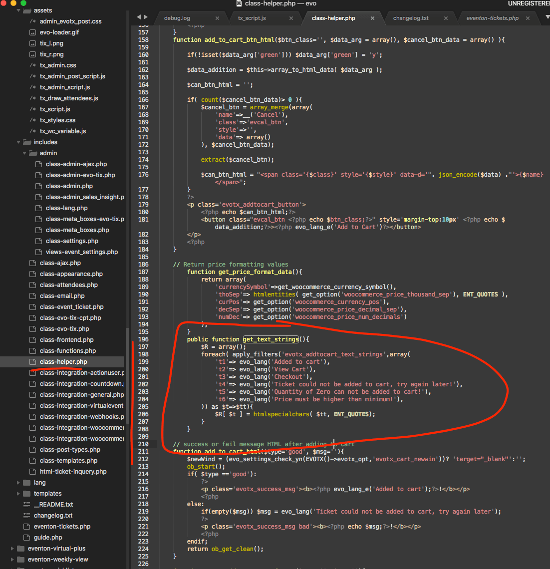

    Matter was about your translation module : in french we use ‘ character in our sentence, and this was in conflict with javascript code ‘SELECT IN’
    HTML output is escaped but seems that JS code using translation not escape it everywhere

    Translation that causing the issue :
    ‘Ticket could not be added to cart, try again later!’
    Screenshot : https://www.dropbox.com/scl/fi/hyh8ugn49h8vf09u6cbbg/event_on.jpg?rlkey=3n01xclvymv63r1gsff2bpmz8&dl=0
    Javascript error (t4) :
    Uncaught TypeError: Cannot use ‘in’ operator to search for ‘Ticket added to cart successfully!’ in {“t1″:”Ajout\u00e9 au panier”,”t2″:”Panier”,”t3″:”Commander”,”t4″:”Le billet n\
    at a.fn.evotx_show_msg (tx_wc_tickets.min.js:1:8554)
    at Object.success (tx_wc_tickets.min.js:1:7055)
    at c (jquery.min.js:2:25266)
    at Object.fireWith as resolveWith
    at l (jquery.min.js:2:77721)
    at XMLHttpRequest. (jquery.min.js:2:80204)

    Super thank you very much for sharing this info!! The ticket seems to be closed on Sept 19, 2023, I reopened it!
    In the meantime here is the patch fix to resolve this issue.
