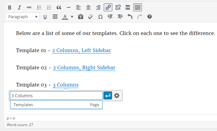

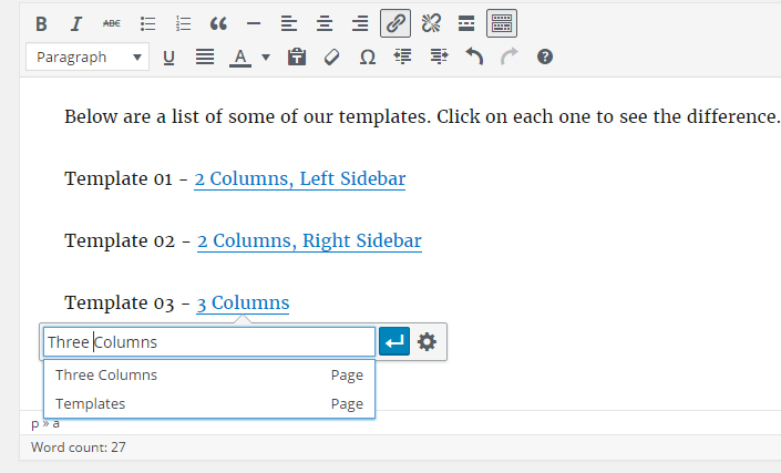

    I can consistently replicate the problem after all. And after playing with it some more, I think I can provide some more information that might be useful.
    Here’s my page structure (using the actual titles):
    -Templates
    —Three Columns
    Now, when I search for “Three Columns”, then it shows up. When I search for “3 Columns” then only the parent page shows up. Now I understand that the search algorithm is not on par with say Google and I don’t expect it reconcile “3” and “Three”. But shouldn’t it pick up on “Columns”?
    See screenshots below:
    https://cldup.com/Nj3ow3cvv5.jpg
    https://cldup.com/wPEmnyro_V.jpg
    And again, for clarification, the screenshots above were made using the WordPress Twenty Sixteen theme with all plugins disabled.

    But how I read it is that child pages do not show up as search results when using the new search.
    @revelationtravis
    The reason this fails (and always will have failed, not just in 4.5-RC) is because we search for them in this manner:
    Search term: “three column”
    Interpretation: Contains “three” AND Contains “column”
    This is why “3 column” will also fail, as it’s not looking for “3” OR “column”
    Also, the search will look either in the title, or the body of the text for these, which is why “Templates” show up as I presume you have written both the number 3 somewhere in there, and the word “column” in some form.
