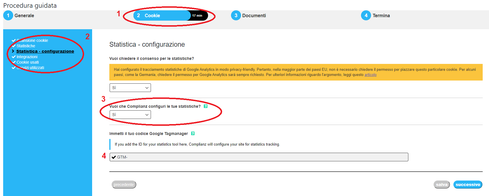

  • Hello, you can find the GTM code using the wizard: select the “2-COOKIE” section on top, then from the left panel select “statistics – configuration”. At this point you have to delete the gtm field and/or set “Should complianz configure your stats?” to “no”. Something maybe different because I’m using the italian translation. Hope to be of help.
    Screenshot

    That did the trick! Thank you very much.
