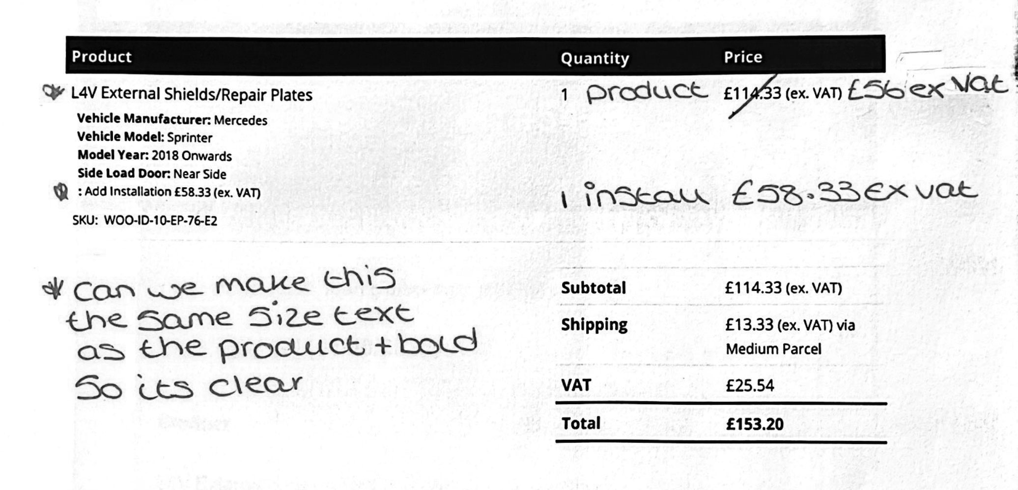

    Hi, we are using Woocommerce Extra Product Options to add an installation add on field to some of our products.
    The PDF invoice only shows a total price, I was wondering if it’s possible to show the product add on as it’s own line on the PDF, with a clearer breakdown. If you look at this link, you can see what we’re trying to achieve. Hope you can help

    Hi @macpheek,
    Based on your screenshot, this data is being added as item metadata, which is within the item itself. Unfortunately, it is not possible to create a separated line for this item meta on our PDF documents, without writing some advanced programming logic, which would be quite complex because there are price amounts involved, without mentioning that this is not covered by the support.
    However, I would ask the developers of the extra product options plugin if there is a way to store the add-on data as a separated item, within the order data, after placing the order. If so, you would not need to do any customization to the PDF Invoices, since it would be displayed as a regular line item.

    Hi, I asked the other plugin author and it looks like this isn’t possible. Is it I can make the text on the extra product option larger so it’s easier to see on the invoice?
    Plugin Contributor Yordan Soares
    (@yordansoares)
    Hi @macpheek,
    You can try to achieve that with this code snippet:
