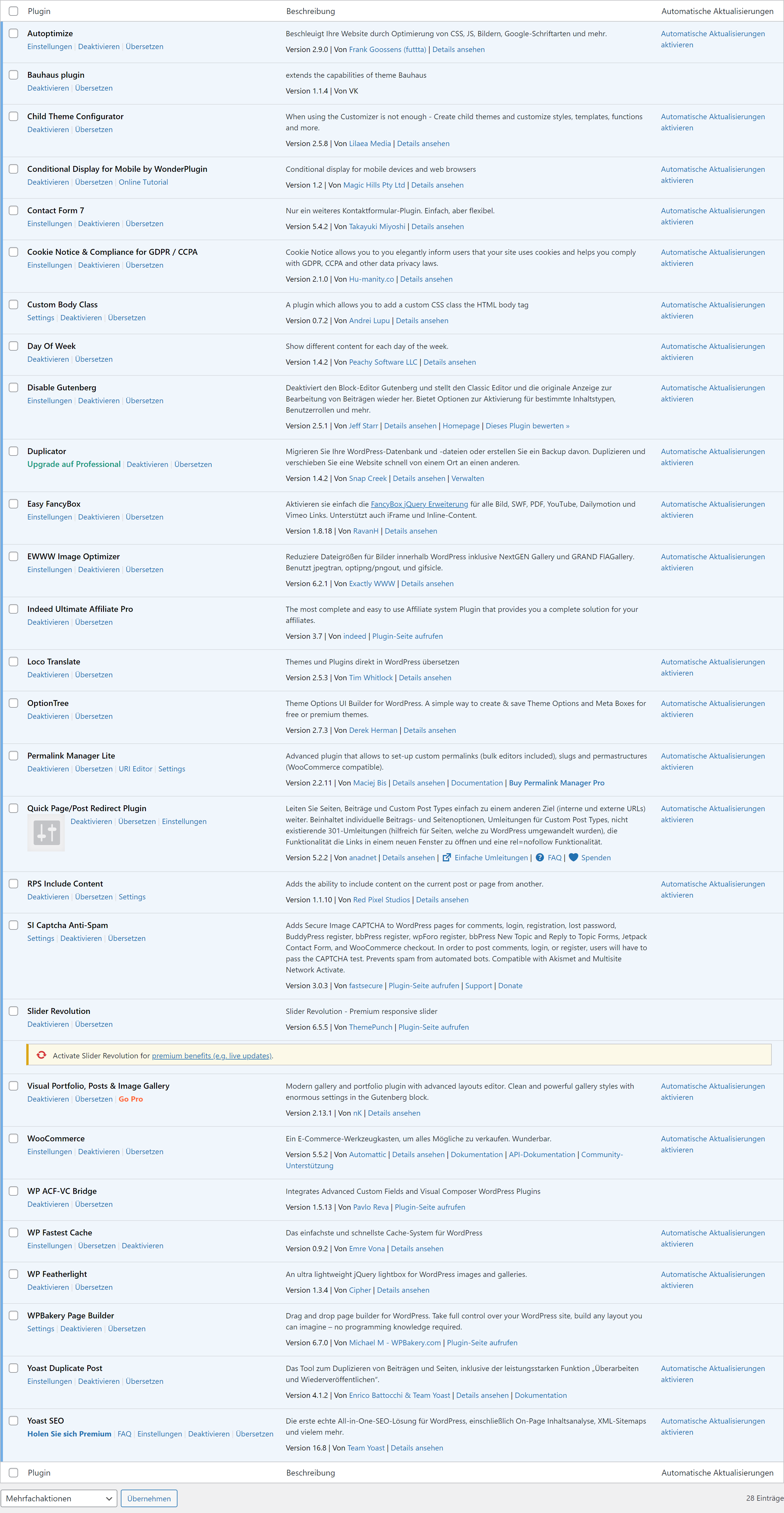

    I just updated one of my sites (WordPress, plugins, theme) on which your plugin is running and unfortunately it now crashes the whole site. The only thing I see is a white screen. After deactivating your plugin everything is back to normal, but the site is more or less useless without your plugin. So that’s no option for me. Do you know what might be causing this problem? Here is a list of all my plugins on this site ( https://i.ibb.co/9t1CN3b/plugins.png ), the current PHP version is 7.4.

    Could you check your server error logs and see if you find a relevant error message?
    Also check section 4 here: https://conditional-fields-cf7.bdwm.be/docs/troubleshooting/does-not-work-with-a-third-party-theme-or-plugin/

    I just noticed that in the list of plugins you shared, there is no mention of Conditional Fields for Contact Form 7.. Are you sure you are in the right support forum?
    Thread Starter Joehann
    (@joehann)
    Yes, I am. As I said, I have to deactivate your plugin in order to make the website work. That’s why it wasn’t in the list I sent you.
