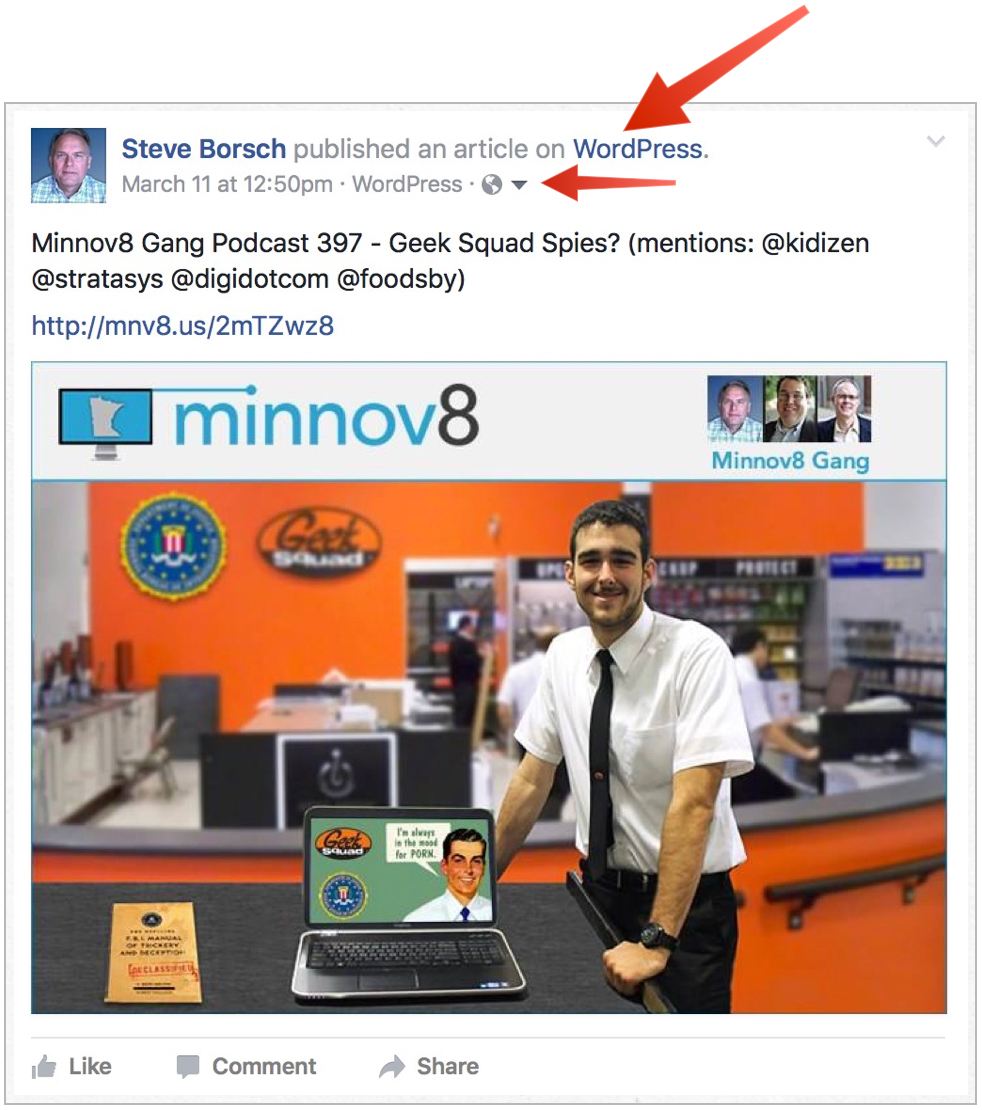

    a) You could have this as the default string as App Attribution for the plugin: “Steve Borsch published an article using WordPress” and have the WP link go to ww.wp.xz.cn instead of .com which would be more acceptable to those of us who self-host (Note: You could have a WordPress.com published article use the .com link and a self-hosted publish link to .org). Having it go to .com is just confusing.
    Also, why are their two links to WordPress in the output? one of my site's published articles on Facebook
    b) Expecting non-developers connecting Jetpack to their self-hosted sites to use Publicize and instead use a tool like SNAP, is like recommending they use a bazooka to kill an ant.
    I appreciate the limitations App Attribution entails but I’ll wager more clever minds than mine could come up with a method that would allow more control for us and inadvertent clicking on a link that would take a Facebook reader to the .com site where they would obviously wonder where the heck they landed!
    I’m afraid that’s not something we can control; Facebook manages the way the posts are displayed. I believe the first mention of “WordPress” is pulled from the app’s “Object” property; that’s described as “The thing the actor interacts with” in app settings. The second mention of “WordPress” is the app name.
