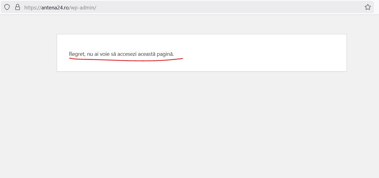

    Am intampinat brusc o problema, un utilizator mia sesizat ca dand sa se logheze pe portalul de aici. o descoperit o eroare. o bagat datele de logare si dintr-o data io aparut “site” “Regret, nu ai voie să accesezi această pagină.” dar dupa ce o sters de la url …/wp-admin/. si o dat reincarcare o aparut ca este logat si functioneaza dar fara sa stearga wp-admin ramane pe acea pagina cu acel text.
    Am verificat si lista de web site-uri alea nu au necazuri.In rest acesta are,am recreat htacces, am oprit toate pluginurile, am schimbat tema,… Unde sa fie problema oare? acel mesaj apare doar la editori si la autori. La admin functioneaza perfect.
    https://postimg.cc/PPVqW8y7
    https://i.postimg.cc/VkmbcqCz/Captur-2.jpg

    Sorry, you are not allowed to access this page.
    This is always displayed if the user with whom you are trying to access content in the WordPress backend does not have permission to do so. This in turn can be controlled by the set role, for example.
    If I understand your text correctly, you are talking about different user groups where this happens. E.g. publishers? And you have created them as users and assigned them to a role so that they can access the WordPress backend (i.e. /wp-admin/) to do things there? How do you manage these users? With WordPress itself under Users (see: https://ww.wp.xz.cn/documentation/article/users-screen/) or with a plugin? If the latter, which plugin do you use?

    Hi, I don’t use any plugins, only the authors are affected, if I give the admin role it works, but the default author role in WordPress doesn’t work, I log in and that message appears, but if I delete the url above/wp-admin and reload only the site domain, they are logged in and it works perfectly, it’s something from the redirection from logging in to the authors.
    After logging in, you always end up in the backend dashboard. The access rights for the author role are apparently missing there. If you do not use any plugin, it is strange how these should change. Where else should the authors end up after logging in?

    Dar am rezolvat problema, in baza de date am avut lipsa unele linii, am rescris baza de date la autori cu un plugin pe urma lam sters. totul functioneaza. baz a de date a fost problema.
