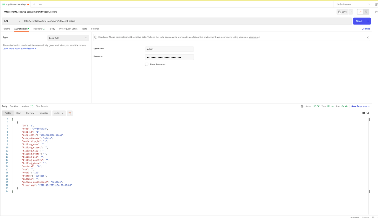

    Here is an image of my postman test to my local environment that’s working:
    https://i.postimg.cc/NMn8YfT7/Screen-Shot-2022-10-20-at-13-56-54.png
