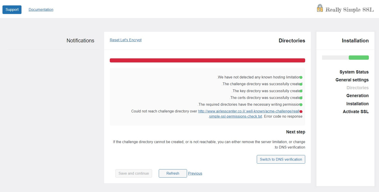

    Hello @airlesscenter,
    The (second) error message means that Really Simple SSL could not reach the “really-simple-ssl-permissions-check.txt” file.
    You can either remove the limitation that prevents the plugin from opening this file, or click the “DNS Verification” button to switch to the DNS Verification method.

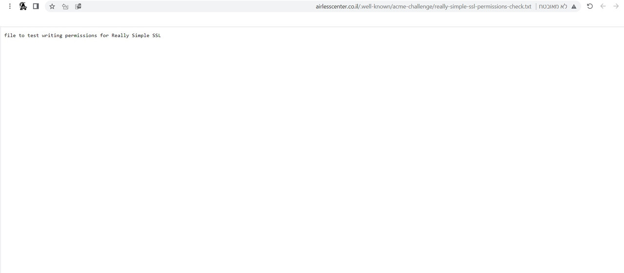

    How can i reach the “really-simple-ssl-permissions-check.txt” file ?
    Plugin Support Jarno Vos
    (@jarnovos)
    If you see the error that Really Simple SSL was unable to reach the “really-simple-ssl-permissions-check.txt” file, this is most-likely due to a limitation that prevents the plugin from checking the file’s availability. It could be that the hosting company blocks the cURL request that performs this check.
    If that is the case, you should see a button to switch to “DNS Verification” while you are on the Directories step of the Wizard. You can then refer to this article for instructions on how to add a TXT record to your DNS settings: https://really-simple-ssl.com/how-to-add-a-txt-record-to-dns/
