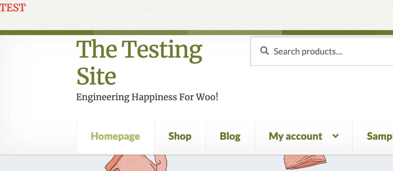

    Hi @artair,
    I gave that snippet a test with both storefront_header and storefront_before_header with PowerPack and BookShop active. The test message did display in both cases for me.
    before_header
    header
    I did not alter the priorities. I ran the snippets through the Code Snippet plugin.
    The only thing I noticed was storefront__before_header needs to have just one underscore (storefront_before_header), but that doesn’t explain the issue with storefront_header though.
