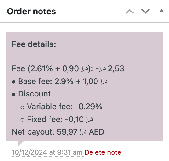

    Here’s the image for the order notes , turns out I am getting some sort of a discount!
    Hi @mohammedmalleck,
    Thank you for the image!
    Yes, the difference you’re noticing in the transaction fees is due to a 10% discount on Payment Processing Fees as part of a promotional offer. This is why the calculated fee is slightly lower than expected.
