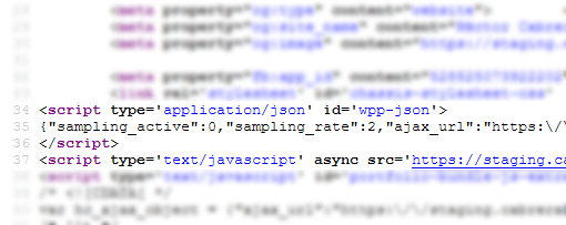

    After turning on js combining, in Google Dev console appears an error: Uncaught SyntaxError: Unexpected token ‘:’ (/wordpress-popular-posts/assets/js/wpp.min.js file). And popular posts design in sidebar gets broken.

    Correct. If you take a closer look at your second screenshot you’ll notice that Asset Cleanup Pro is trying to execute a JSON string as if it was a regular JavaScript code. Hence the Unexpected token ':' error message you’re seeing.
    Ideally, Asset Cleanup Pro (and other plugins like it) should not attempt to minify / bundle inline script code, only actual .js files. Or at least check that the inline script is not a type="application/json" one (like WPP’s) before attempting to bundle its contents into a minified JS file.
