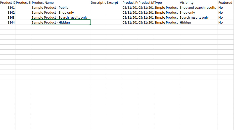

    Hi @spbuckle, yup, I see exactly the same as you. I’ll get to the bottom of this now by comparing Post meta and any Term changes.
    Hi @spbuckle, yup WooCommerce now does some special sauce for generating the Visibility, it’s not even a single Term we have to query but check several (e.g. exclude-from-search and exclude-from-catalog = Hidden)
    https://www.visser.com.au/wp-content/uploads/2017/08/screenshot-woo_cd-visibility.jpg
    I’ll get this code into a minor Plugin release for the w.org Plugin here and push this shortly πŸ™‚
    Hi @spbuckle, 1.9.2 has just been pushed which includes the Visibility field change, let me know how it goes. Thanks again for the bump and for reporting this, back to my wall of tickets πŸ™‚

    Hi @spbuckle, thanks for persevering, I’ve made a change in the update going out in the next few minutes resolving this. I have been working with a customer too to make sure this fix is solid and applies to all Visibility types.
