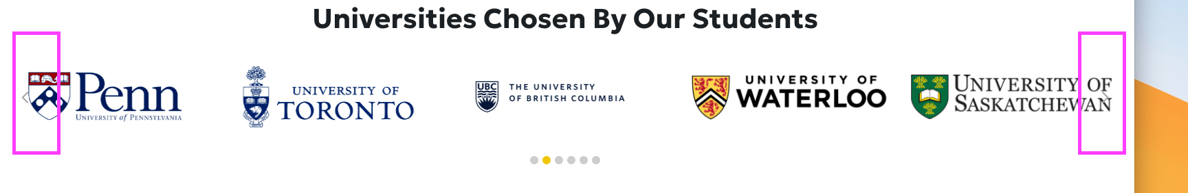

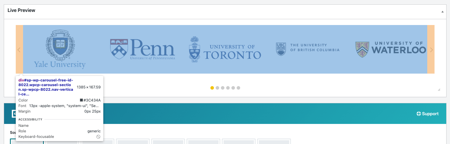

    Thread Starter Kyle
    (@kylebravotangoca)
    How come all the default styles are not being applied to the carousel via Divi? Also the workaround is missing padding on the container as well:
    Front End:
    Back End Preview:

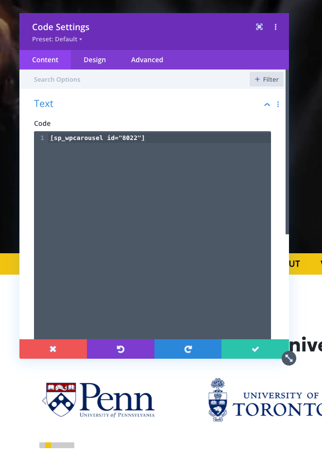

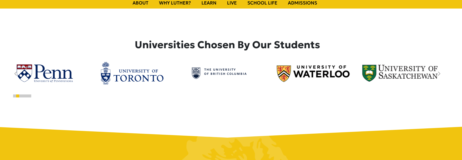

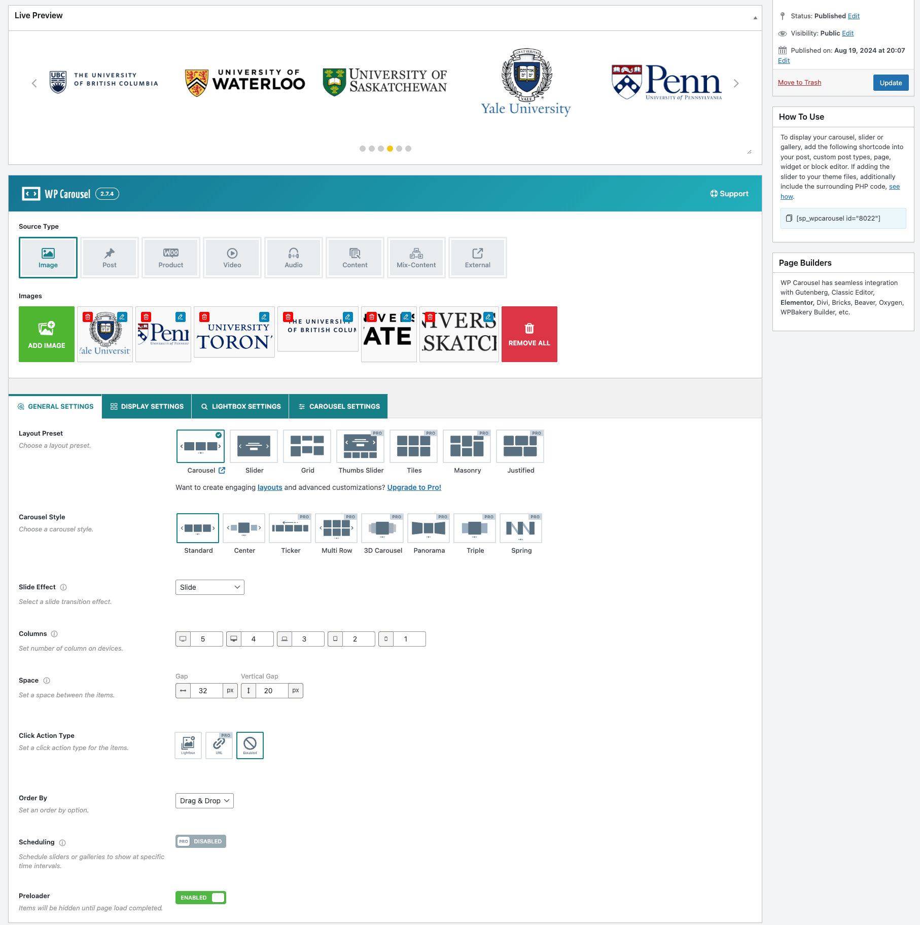

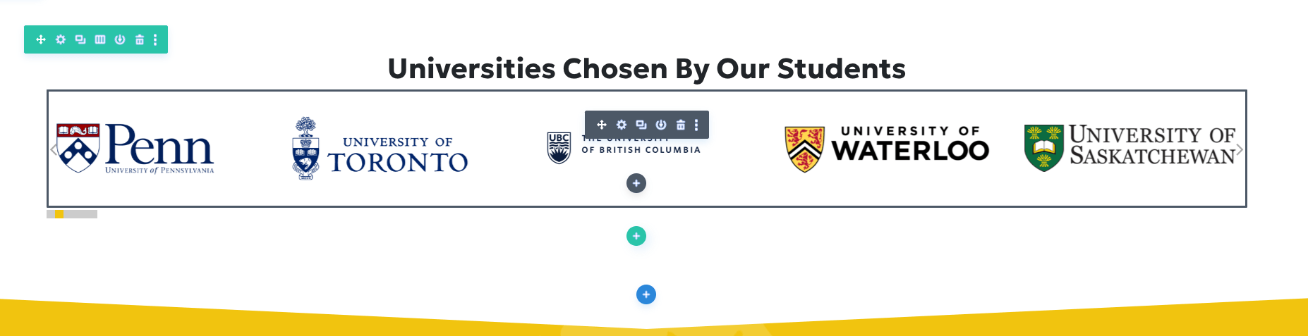

    Thread Starter Kyle
    (@kylebravotangoca)
    I’m not 100% sure what you are after so I included screenshots of everything:
    Front End:
    Back End:
    Divi:
    WP Carousel:
