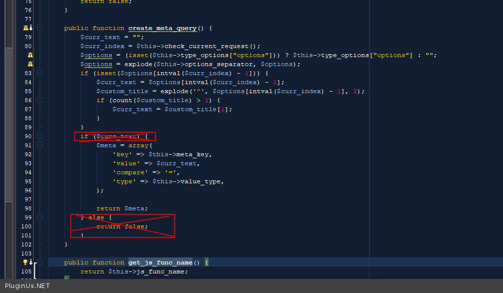

    In file -\wp-content\plugins\woocommerce-products-filter\ext\meta_filter\html_types\select\index.php
    Delete this code – https://c2n.me/4dCoYvn.png
    and do a test
    Thread Starter nickdill
    (@nickdill)
    I tried drop down as number and drop down as string. I removed the code you suggested and nothing changed. If I list the values “-1,0,1,2,3,4” the 0 does not show up in the drop down.

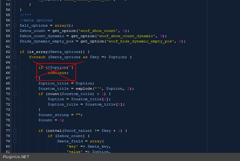

    Try in file -\wp-content\plugins\woocommerce-products-filter\ext\meta_filter\html_types\select\views\woof.php delete thid s code – https://c2n.me/4dDSRab.png
    (@nickdill)
    When I deleted the code you referenced in -\wp-content\plugins\woocommerce-products-filter\ext\meta_filter\html_types\select\views\woof.php, I could see the 0 values as drop down options in the front end. When I click on the 0, it puts the slug in the URL too but the results are still as if I didn’t click anything. So that fixed the selection in the frontend and added it to the URL but it still does not show correct filter results.

    I tried leaving that code and removing that code in combination with removing the code from \wp-content\plugins\woocommerce-products-filter\ext\meta_filter\html_types\select\views\woof.php. Nothing gives proper results but when I remove that if statement with the continue line from the woof.php file, the 0 option at least shows up as an option. When I select the 0 value the results are still not accurate.
    I went ahead and looked at the line from the index.php file you referenced and changed the the if($curr_text){ to if($curr_text || $curr_text === '0'){ and it began working as intended. So changing that if statement and removing the continue; from the woof.php file fixed the issue. The drop down is working but I really need to use checkbox instead. What changes would need to be applied to get this working with checkbox?
