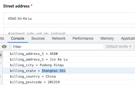

    This does not complete the CHINESE State Province as seen here:
    https://prnt.sc/zs4wlu
    How to fix?

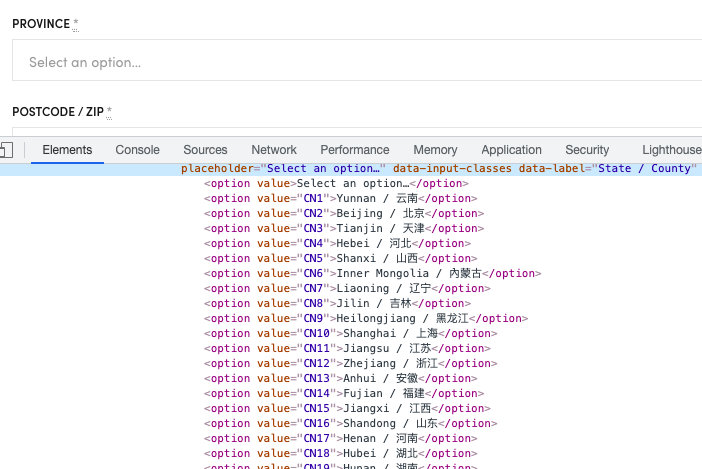

    The province or state are not autofilled because the returned billing_state or shipping_state value from Google Places API are different from the default WooCommerce state codes.
    For example, for this particular address: 4560, Jin Ke Lu
    Places API: Shanghai Shi
    WooCommerce State Value for the dropdown: CN10
    In order to make sure that the state field is autofilled with the Places API, we will match the result with the corresponding state code value in the autocomplete.js file.

    This is what we will get when all the state codes are properly assigned:
