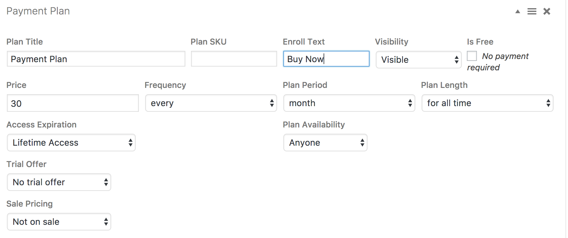

I think you might be confusing lifetime access with plan length.
Please see this screenshot: http://lifterlms.com/wp-content/uploads/2017/10/monthly-access.png

I believe the issue, based on your screenshot is that it says:
“$2 Every Day for 1 Day”
There is no next payment because you said the plan should only last for 1 Day
Instead try to get it so it says
“$2 Every Day for 30 Days”
That means it will charge $2 Every Day for 30 Days, so the next payment date will allwys be the following day, and the billing will stop after 30 days.
