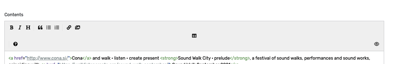

    Progress! I now got this to work in the frontend. Though the visualisation of the button bar is messy.
    https://i.postimg.cc/43mR6HHC/Screenshot-2024-05-02-at-11-17-18.png
    However, more problematic is this: I’m using this field for a taxonomy term, and in the backend, the editor now does *not* load. I get the spinner icon that never disappears.

    @mastababa it’s a great news we are getting closer ! 🚣
    Yes I haven’t checked in details but from my tests a few styles on the frontend are probably overrides / conflicted with your theme. 💦 Gonna think later on how to upgrade that.
    About the taxonomy that’s not good, you mean the ACF Markup Markdown do not load anymore ? Or the taxonomy content ? Another user reported a similar issue as well. 😓 If you can tell me a little more please, that would be really helpful.
