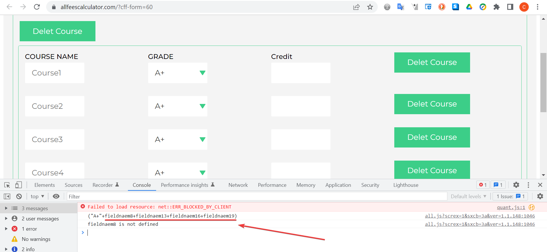

    First, you should check your equations because you are using fieldnaem, like fieldnaem8, but the correct is fieldname (fieldname8, …)

    Also, you have not fixed the typos in the equations. Please, look at the screenshot below:
    You have typed fieldnaem instead off fieldname.

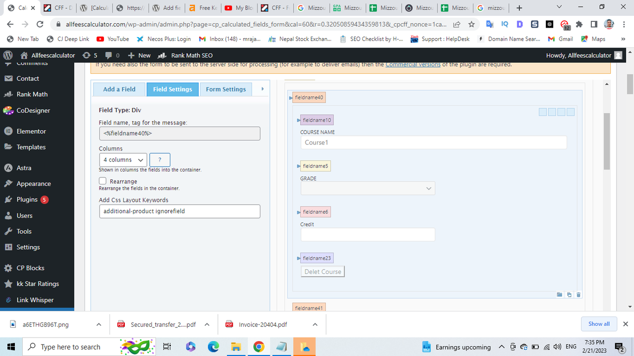

    i have put in the div field that contains and when we put additional-product ignorefield in the Add Css Layout Keywords then the class hide automatically but I want to click on the delete button after delete and hide

    Please check the url https://i.postimg.cc/L8yZJknY/Screenshot-21.png we have included in the div field
    Plugin Author codepeople
    (@codepeople)
    Hello @ajaysingh121
    Excellent !!! But you have applied it to the first row only. You must apply it to every row.

    I have applied every row, the screenshot is only for your verification additional-product ignorefield hides the row so now we have used to ignore field in the first row only.

    I’m sorry, but you are not applying the additional-product class names to the other rows. Also, the ignorefield class name should be assigned to the extra rows, and not the first one.
