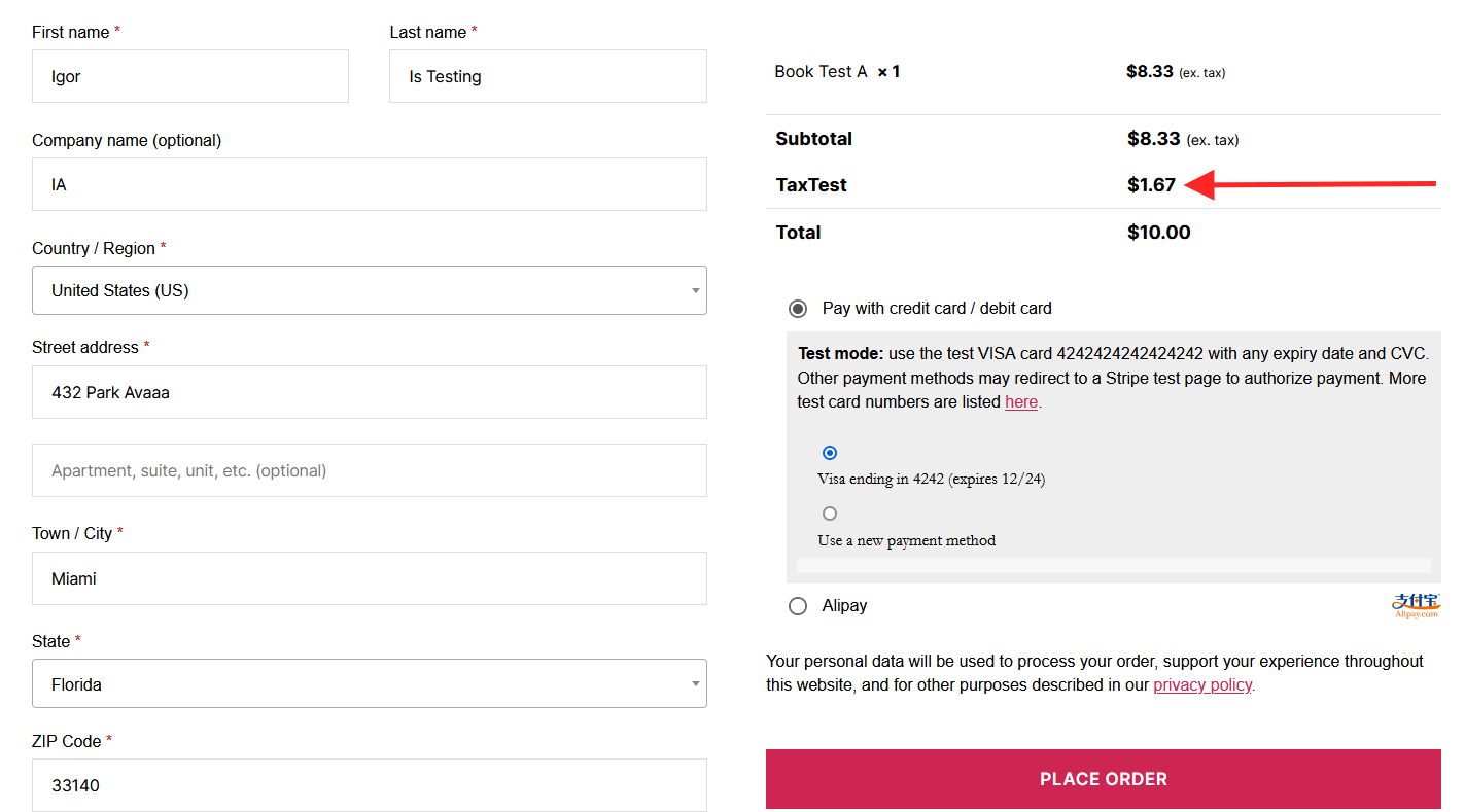

    For that, kindly go ahead with adding an additional tax class, as showcased here.
    Subsequently, go ahead with setting its tax rate, as showcased in this example.
    Lastly, make sure that the related option is selected, for the related activities, as shown here.
    Here is the end result, on the checkout page.
    I trust that clarifies things further. If you have more questions, let us know. We’re happy to help.

    In addition to the previous comment.
    Please note that the setting Calculate tax based on will always be set to Customer Shipping Address when the Automated Tax settings of WooCommerce Shipping & Tax are enabled.
    You can use tax classes though with custom taxes configured (This is a workaround). For example, lest’s assume the shop address is based in California.
    You can use a wild card tax rate, so it applies in the USA regardless of the address entered during checkout.
    Link to image: https://snipboard.io/IG7tTc.jpg
    Once the tax class is assigned to the product, the customer will be able to add that product to the cart, as long as their country is the USA, the tax rate should display regardless of what address they enter.
    Link to image: https://snipboard.io/zcMrvC.jpg
    This is the result on my testing site:
    Link to image: https://snipboard.io/gCzdly.jpg
    Link to image: https://snipboard.io/eucmL7.jpg
    I hope this points you in the right direction.
