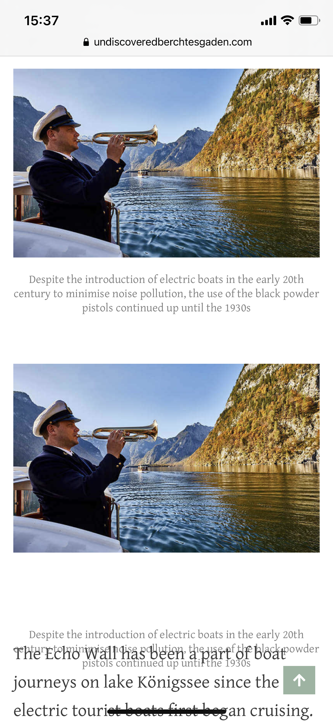

    I’ve duplicated all images in the same way (first a 100% column, second the image with no container) on https://undiscoveredberchtesgaden.com/self-guided-tour-of-lake-konigssee/ and there’s a screenshot showing the glitch here:
    https://undiscoveredberchtesgaden.com/wp-content/uploads/2021/04/Help-6.png

    Thanks for the update, great that you also made a page with all the image variations. I’ve performed some additional checks on your site using different browsers and emulators although I don’t encounter the same misplaced captions (example with the same image you referenced).
    while I’d like to open a GitHub issue for this we’ll need some more insights unfortunately. Firstly can you share the full markup after switching to a code editor view (just for that image).
    Secondly can you share whether the same occurs on your side when using another browser or device?

    Yes I’ve tested using another iPhone and laptop (windows) and seen similar behaviour.
    Here is the non-visual editor code for two of the images showing this behaviour:
    <figure class="wp-block-image size-large"><img src="https://undiscoveredberchtesgaden.com/wp-content/uploads/2021/03/Lake-Konigssee-Echowand.jpg" alt="" /><figcaption>Despite the introduction of electric boats in the early 20th century to minimise noise pollution, the use of the black powder pistols continued up until the 1930s</figcaption></figure>
    <div class="wp-block-image"><figure class="aligncenter size-large"><img src="https://undiscoveredberchtesgaden.com/wp-content/uploads/2021/03/Lake-Konigssee-Echowand.jpg" alt="" /><figcaption>Despite the introduction of electric boats in the early 20th century to minimise noise pollution, the use of the black powder pistols continued up until the 1930s</figcaption></figure></div>
