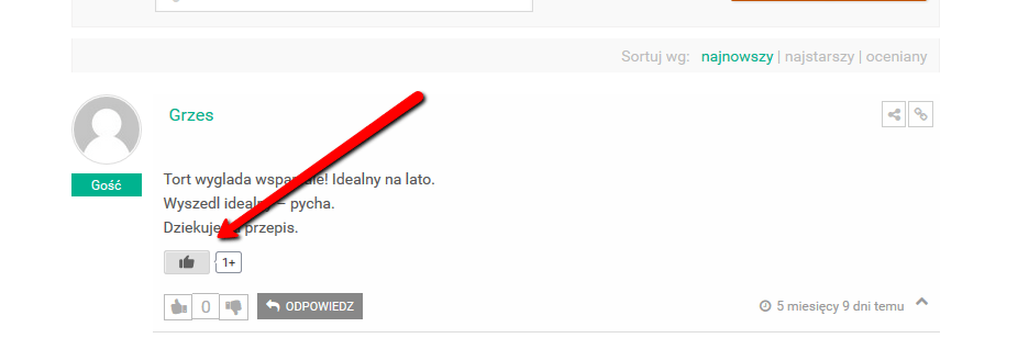

    Please disable all plugins except wpDiscuz then delete caches and test it, this is plugin conflict. During last two years I’ve never seen such problem.
    I see something non-wpdiscuz:
