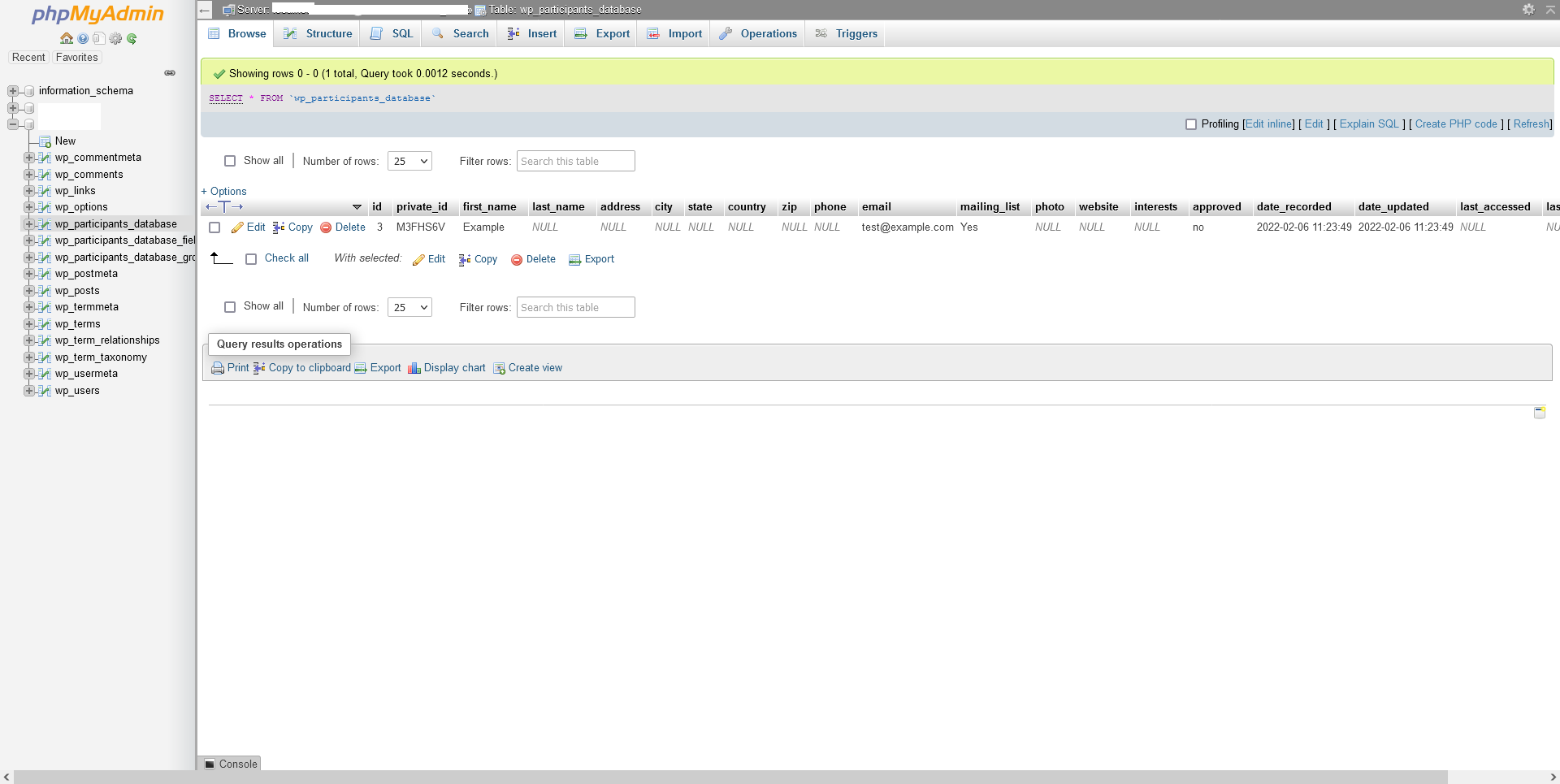

    Here’s also a screenshot of what timestamp Participants Database has written into its table. The values look correct there:
    https://i.postimg.cc/gYqZ2222/Screenshot-2022-02-06-at-11-29-22.png
    With respect, by process of elimination, something in Participants Database seems broken to me.

    If you look the query that is used to write a record to the database, you’ll see that for the timestamp, it sends “NOW()” as the timestamp value. The plugin does not change the configuration of the database server, so how it assigns the value of NOW() depends on how the server is configured.
    Other plugins may be setting the timestamps with a specific value, so that could account for the difference.
    If there is a bug, I would be happy to fix it, but as far as I can tell, there isn’t anything wrong with how the plugin is interacting with the database server.
    I also don’t see this problem in my tests here. Our database server is set to UTC (which is standard) and the timestamps I am seeing in my tests are correct.
