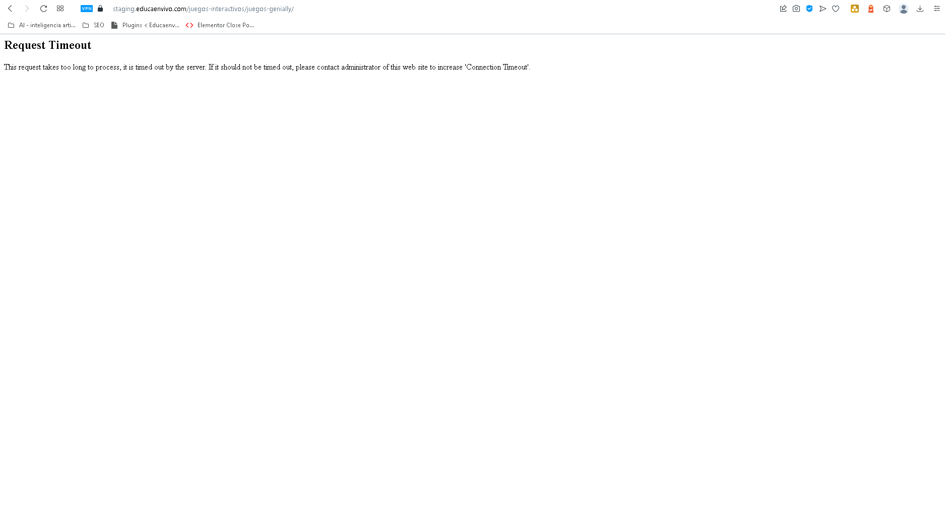

    1. If you load a page from a browser/ip you’ll see it takes several seconds to charge. Then if you refresh it from the sape browser/ip you’ll see it loads in a few ms. But if you change the ip you’ll see the same page takes several seconds again to charge.
    2. Request timeout error:
      https://i.ibb.co/C2vbPtg/request-timeout.png
    3. Google page speed are not being able to load the pages that are being served with Lite Speed active. Example: https://pagespeed.web.dev/analysis?url=https%3A%2F%2Fstaging.educaenvivo.com%2Fcuentos-infantiles%2F25-cuentos-con-pictogramas-pdf-imprimibles-y-gratuitos%2F
    4. If you analyse the same page with Swift performance activated (unoptimized but with cache activated) Page speed insights can make the test. Example in the main domain: https://pagespeed.web.dev/analysis/https-educaenvivo-com-cuentos-infantiles-25-cuentos-con-pictogramas-pdf-imprimibles-y-gratuitos/oajzvnh1mu?form_factor=mobile
    Plugin Support qtwrk
    (@qtwrk)
    1. it works fine on , did you check it as login user ?
    2. that should be something else , you may need to check your server log
    3. 4. PSI seem work on me
