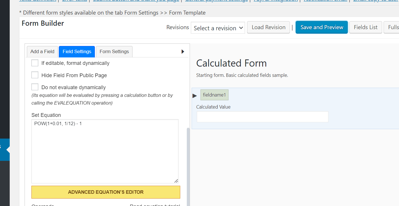

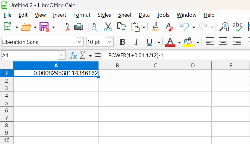

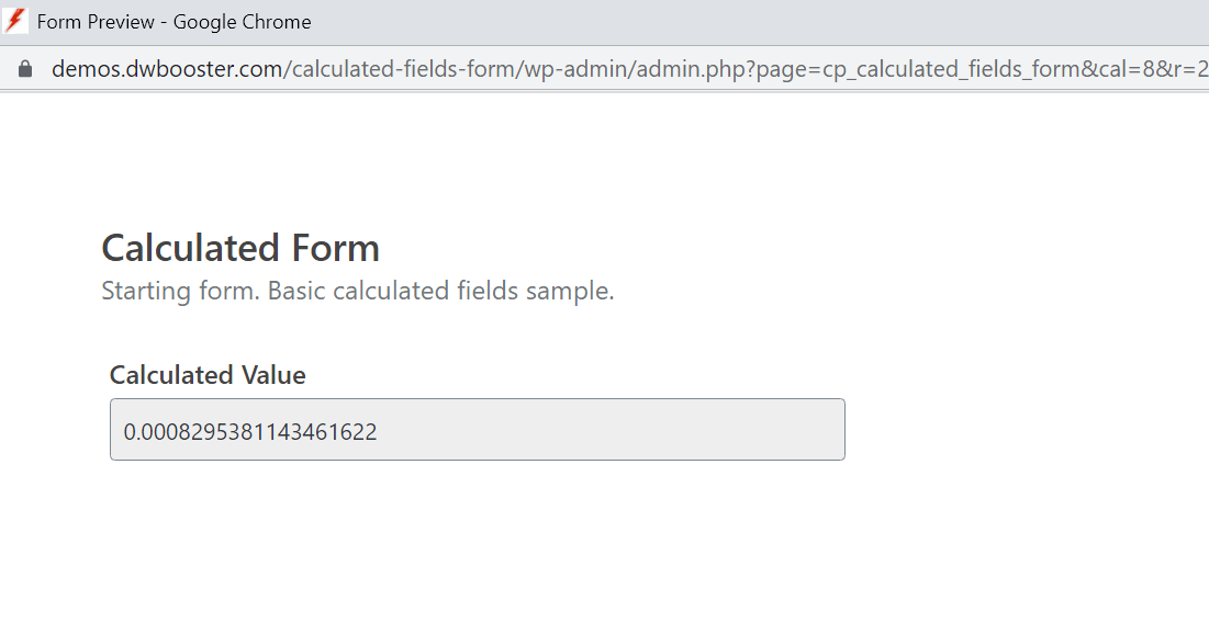

    Hello @klingbeil
    The calculations performed by the plugin are right, you should check if your formulas are correct. Please, look at the screenshot below. I implemented the mathematical operations in LibreOffice – Excel, and our plugin to allow you comparing results:
    LibreOffice – Excel
    Equation settings.
    The form
    Best regards.
