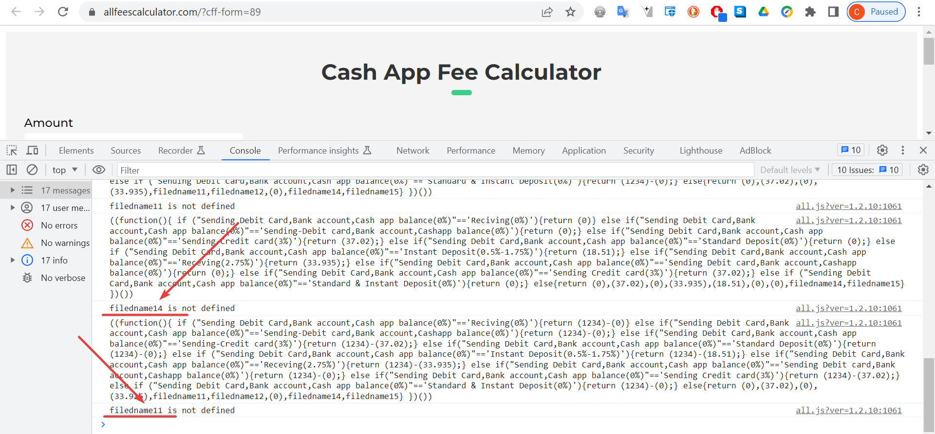

Hello @ajaysingh121
There are typos in the equations you entered in the fieldname5 and fieldname6 fields. You entered filedname11, but the correct one is fieldname11

Hello @ajaysingh121
I responded to your question. I checked your equations, and you entered the field’s name with typos. You entered filedname11, but the correct one is fieldname11.

Hello @ajaysingh121
I visited your form again, but you have not resolved the issue with fields’ names in the equations:

Hello @ajaysingh121
You have typos in multiple fields’ names. Please, check your equations’ code. I visited the form again, and the issues persist:
