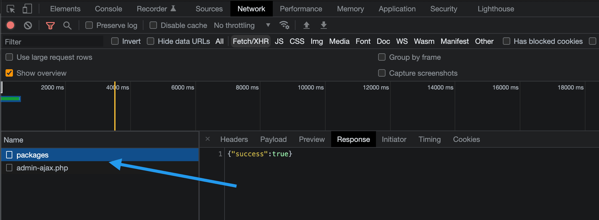

    Hi @magicmitch,
    Going back to your first post, the boxes are stored along with additional information for this extension in the _options table under wc_connect_options.
    Let’s do this and see if it has any more information. Go to WooCommerce > Settings > Shipping > WooCommerce Shipping. Then open up your browser’s developer tools and click on the “network tab.”
    Then attempt to add a product and see what it shows you for the response to the “packages” request.
    You can copy and paste the response or take a screenshot and share it too. You can use https://snipboard.io for sharing screenshots – please follow the instructions on the page, then paste the URL it gives you in your reply.
