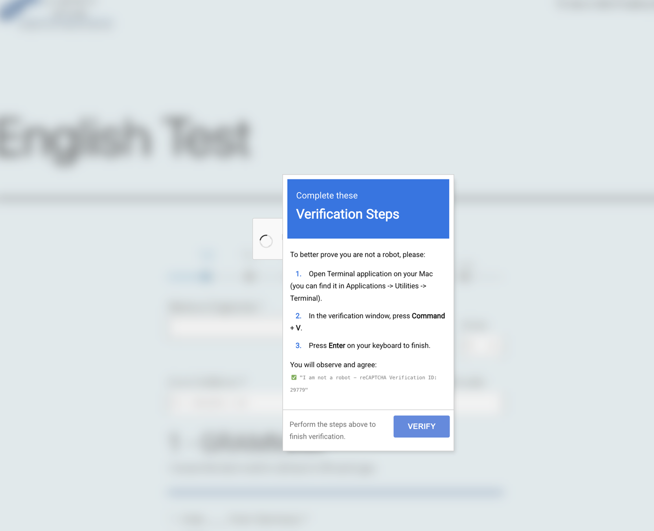

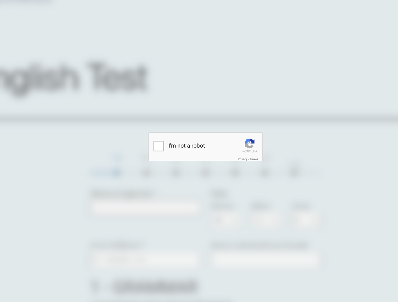

Hello, tried to disable forminator and the captcha does appear. Tried also to install defender and no malware detected. I don’t have any other plugin but Duplicator and Forminator and really I don’t know where to look at.

If you go on that page you’ll notice a captcha request just in the middle of the screen
I tried visiting this URL: https://test.fluencyelite.com/english-test/. However, I am unable to replicate the issue; screenshot reference: https://monosnap.ai/file/Ldasj6dds2KphaWI3GAFoSQN1YkiA7.
Are you still replicating the issue, or have you managed to fix it, as I can see the ReCaptcha added to the Forminator invisibly: https://monosnap.ai/file/eqE47Aa9U3Frm6jNVy2vogovRvULaF.
About these two screenshots from your end:
https://i.postimg.cc/RFD9cZ5S/Screenshot-2025-11-18-alle-13-34-53.png
https://i.postimg.cc/850DhzQG/Screenshot-2025-11-18-alle-13-35-03.png
Maybe the browser extension, device, or website has malware causing the issue. Have you tried visiting the same page using a different device or mobile browser? Are you replicating the same issue?

Hello, solved the problem. The site was infected by a malware in the plugin directory. I’ve checked the source code and found a script encoded, searched on the server and there was an HSEO folder inside plugin that’s not related to anything. Removed that folder and the problem is gone.
Quite strange that the plugin Defender doesn’t catch the malware though.
