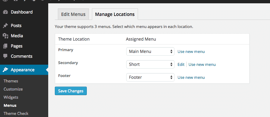

    This can be accomplished with custom menus. If you head over to the Menus page (found under Appearance), you’ll be able to create your own custom menu. On the left-hand side you can select Pages, Links, or Categories to add to your menu.
    After you’ve created your menu with the list of categories, you can assign its location to either the Primary, Secondary, or Footer location (screenshot) by clicking on the Manage Locations tab at the top.
    In the Tracks live demo, we have a few pages in the Primary menu (top-right), and categories in the Secondary menu (top-left).
