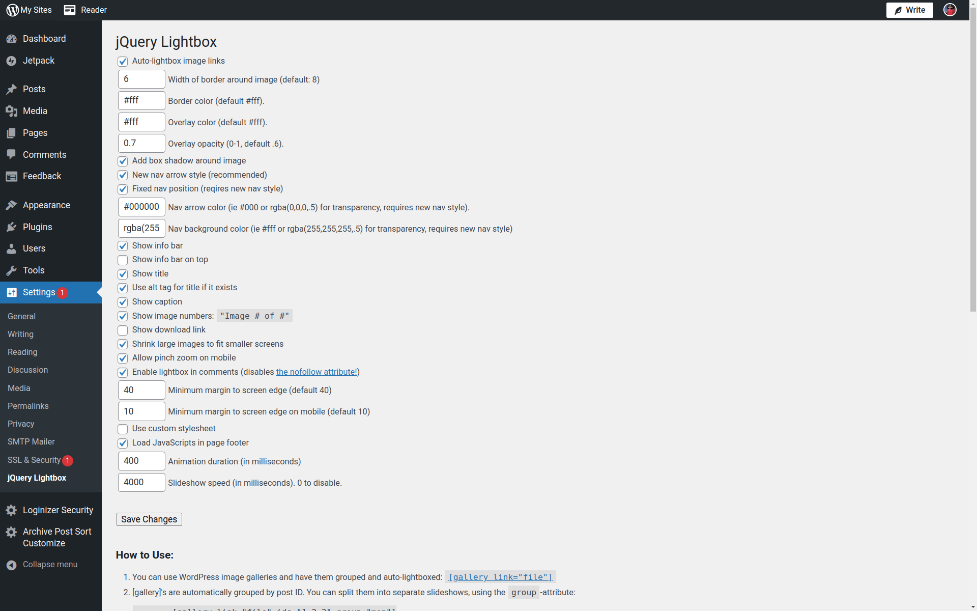

    jalapenojuan
    (@jalapenojuan)
    Hi. I’m experiencing a similar problem.
    Here are my settings
    The picture does have a caption:
    Which shows in the post:
    But not in the lightbox:

    @jalapenojuan – Thanks very much for the detailed post and the screenshots. Your issue is puzzling. Based on what I see, captions should be working. I retested to confirm it works as expected. For me, using image with a caption like your, with your lightbox settings, the caption does show. I can play around with things a bit more to see if I can find a way to duplicate. Just to be sure we’re on the same page, what are you using to insert the images/gallery? Is that the block editor and a core Gallery block, or something else? Based on how the gallery is rendered, it doesn’t look quite like I’d normally expect a Gallery block, but it could be the theme adjusting styles a bit.
