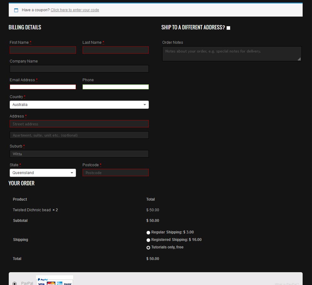

• I don’t know why or when this happened but my checkout page has changed colour in a few spots, maybe after an update it changed, attached is a screenshot of my page, basically i want all the white to be dark like my site with light grey text.
    http://www.magmabeads.com/test/1.jpg
    Not everything has changed, a lot of the boxes are still good, but the top coupon bar is now white, email address, phone, and bottom paypal bar.
    my site is http://www.magmabeads.com if you want to see, you have to add a product to see the checkout page.
    Does anyone know how to get the colours back to what it was? or point me in the direction of the area to edit?
    Thank you all for any help.

  • Try this in your custom css:
    .woocommerce .woocommerce-info, input,
    .select2-container .select2-choice,
    .woocommerce-checkout #payment
    {background-color:#232323}
    If your theme does not have a setting where you can enter custom css, you can use a plugin like this one:
    https://ww.wp.xz.cn/plugins/simple-custom-css/
    Avoid editing the theme’s style.css so that changes aren’t overwritten by updates.

    Thanks Lorro,
    Unfortunately that did not work, i don’t understand as everything was fine recently, i don’t even know when it changed…
    The weird thing is that only a few items are white, the rest are all good.

    To get all the inputs looking alike, try:
    input[type="text"], input[type="email"], input[type="tel"] {padding:8px 9px; color:#afafaf}
    .select2-chosen {padding:4px 9px; color:#afafaf}
    Persevere with the updates or your site will eventually have problems and may have security vulnerabilities which would otherwise be patched.
    Thread Starter t3x66
    (@t3x66)
    That works really well, thank you so much Lorro !!
