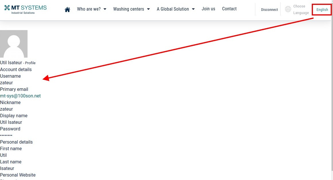

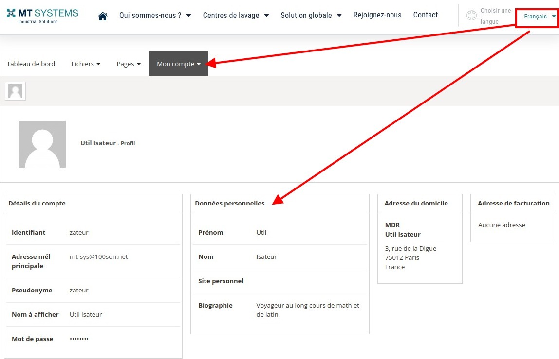

    Yes the menu is translated, but it’s not displayed.
    Look at those two images.
    With french language selected.
    With English language selected.
    As you can see with englisn language the menu (existing in English) is not displayed and all the layer is destroyed. Have you an idea of what is doing this?

    Obviously, some fixes are needed to let WP Customer Area and Polylang work together.
    The layout is destroyed, probably because :
    • the assets (skin/frontend/master/css/style.css are missing from the translated page
    • the classes customer-area or customer-area-active are missing from the body tag
    Not sure why the menu isn’t displayed. I should test that in order to be able to answer more precisely. But I’ll be honest, we currently have many updates to finish, and this will not be a priority. I can’t give any ETA about this sorry.
