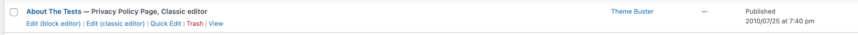

OK. Getting there, thank you. In settings I now have Allow users to switch editors enabled. But on the pages list I don’t see the option, when hovering over the page title. In italics on each page line is ‘classic editor’, but no option there to change anything, or on any component of the line.
Under settings however there is a default editor for all uses which shows either classics or blocks.
Glad to hear you’re making progress. If the option to switch editors is enabled, you should see the following on the Pages page when hovering over a page name.
https://siteorigin.com/wp-content/uploads/2023/02/choose-editor.pngThere is also a meta box available in the right column when editing a page.

Thanks for the update. Apologies; Page Builder will maintain the format it’s in, this case, the Classic Editor. The Classic Editor plugin will need to be temporarily deactivated to open the target page in the Block Editor.
Once you’ve exported the JSON file, try the following:
– Temporarily deactivate the Classic Editor plugin.
– Open the page in question, click Revert to Editor, and clear the page contents completely. Click Save. The page will revert to the Block Editor.
– Insert a SiteOrigin Layout Block and import the JSON file.-
