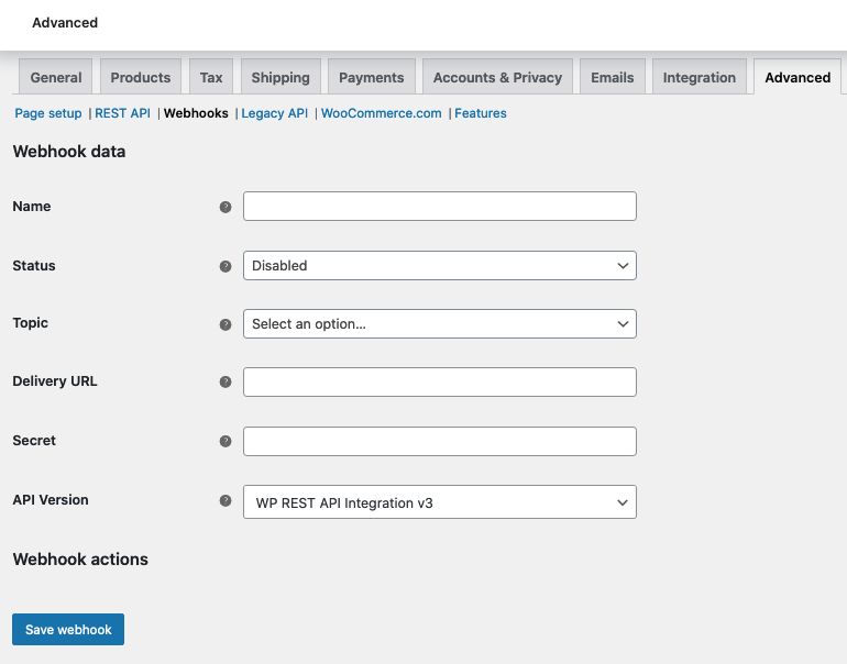

    Sure! I cross-checked it on my test site and confirmed that the URL linked to the button is correct. (http://test-site.local/wp-admin/admin.php?page=wc-settings&tab=advanced&section=webhooks&edit-webhook=0)
    Once you click the Add webhook button, you should see a page like this:
    On this page, the Add webhook button is then replaced by the Save webhook button to save the settings of the new webhook you create.
    You can find more information about webhooks here: https://woocommerce.com/document/webhooks.
    Could you please confirm if you see the same fields like the image above?
    If not, please share a screenshot of what you see when you click the Add webhook button to check further. You can use the snipboard.io tool to share it.

    Sorry for my earlier reply. Actually Add Webhook button is visible all time but when I click that the next screen is blank, neither Create New Webhook button at right bottom corner is visible nor any form opens.
    Thread Starter wellbiance
    (@wellbiance)
    Enter Webhook data form does not show up

    Hi @wellbiance
    Thanks for sharing the System Status Report. Mostly looking good – nothing particularly remarkable.
    Glad to know that the add webhook button is opening the Webhook Data form now. 🙂
    Now will need to figure out which plugin is conflicting its performance.
    Correct. In order to figure out which plugin was causing the problem, you’ll need to reactivate the plugins one by one, testing after each, until you find the one causing conflict. Once the culprit is detected you’ll want to report the issue to the plugin’s developer.
    Cheers

    Found the plugin its Caldera Forms when active disables the Webhook form
    That’s great! We are glad that you found the culprit; thank you for sharing it.
    Now that you have identified the cause, you can get in contact with the Caldera Forms support team so they can assist you further with this matter.
    You can contact them here: https://ww.wp.xz.cn/support/plugin/caldera-forms/#new-topic-0.
    I’m marking this thread as resolved now. If you have any further questions, I recommend creating a new one.
    Cheers!
