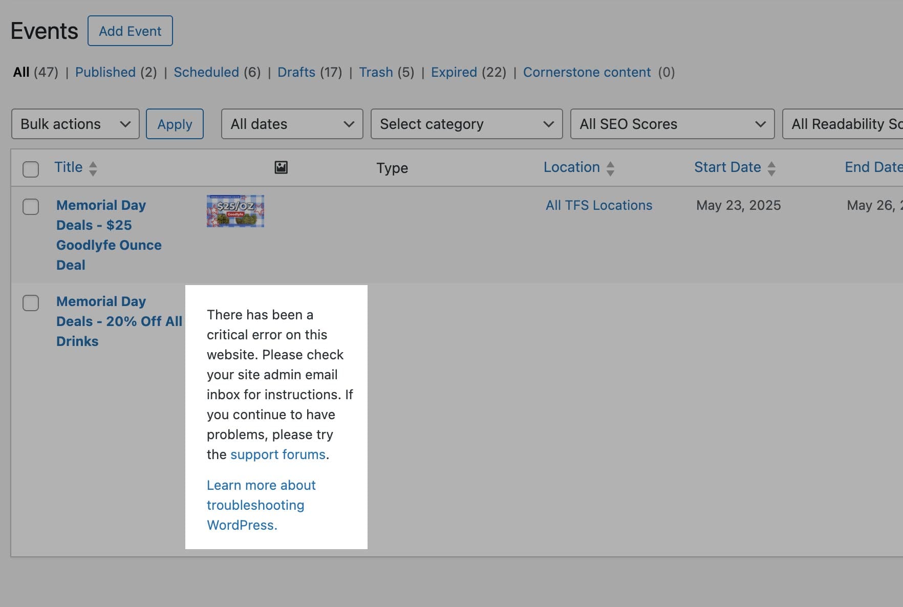

    Hello, I am receiving this same issue on my website thefirestation.com:
    PHP Warning: session_start(): Session cannot be started after headers have already been sent in /home/moptkfo/public_html/wp-content/plugins/wp-event-manager/includes/wp-event-manager-post-types.php on line 805
    Also on the back-end I get a critical error which you can see in the attached screenshot: https://thefirestation.com/wp-content/uploads/2025/05/Screenshot-2025-05-28-at-7.54.26 PM.jpg
    Any suggestions as to how we can fix this?
