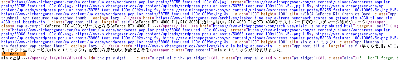

If the article “text A” has a small number of characters and the excerpt has a large number of characters set, the WordPress Popular Posts widget will include “<! –more–>” is included in the source.
https://www.nichepcgamer.com/wp-content/uploads/2022/09/more-1.png
Depending on the character count setting of the excerpt, the source would look like this.
https://www.nichepcgamer.com/wp-content/uploads/2022/09/more-2.png

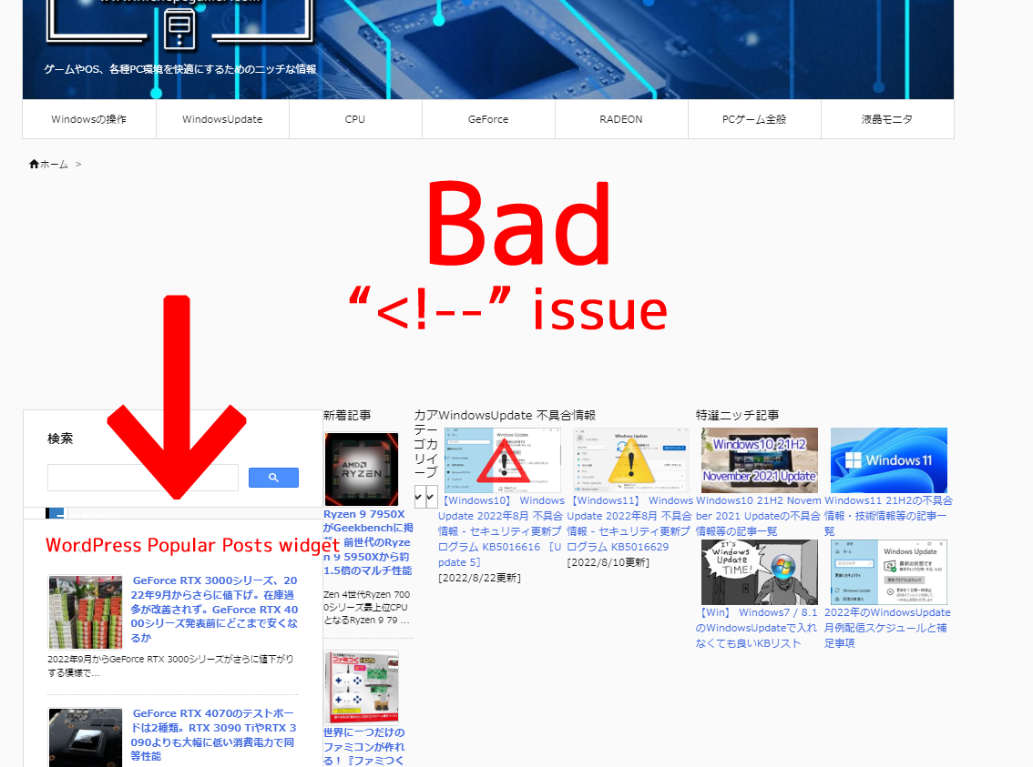

The HTML tag is not closed due to “<!–“.
Then the website will be broken as follows.

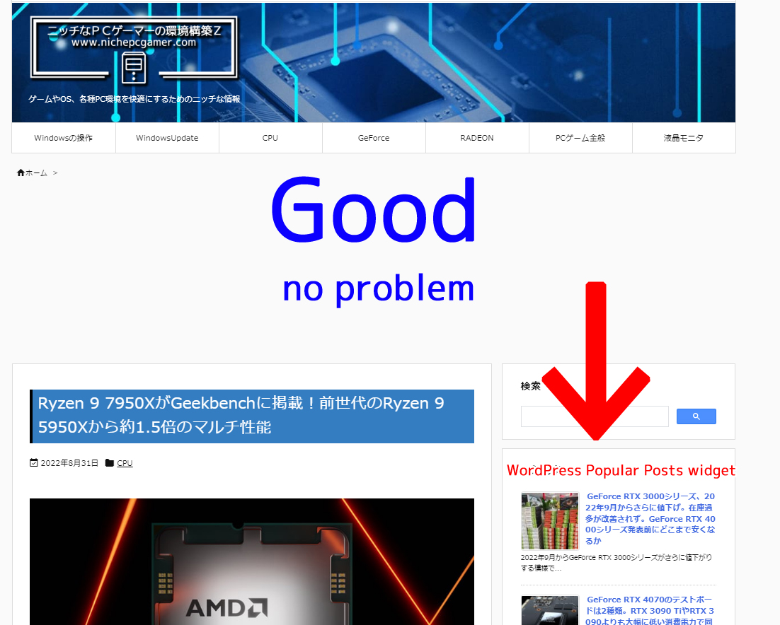

Normal Web site
https://www.nichepcgamer.com/wp-content/uploads/2022/09/n-good.jpg
Broken Web site
https://www.nichepcgamer.com/wp-content/uploads/2022/09/n-bad.jpg
