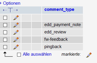

    So here is the result
    https://i.ibb.co/VS3Wnq5/comments.jpg

    Plugin Author gVectors Team
    (@gvectors-team)
    Ok, all is clear, you have about 30,000 payment notes, this is way you see that statistic. We’ll add an option to filter comments in future releases. The ‘edd_payment_note’ will be filtered too. Currently, there is no solution I can provide you, because the problem is not from wpDiscuz side.
