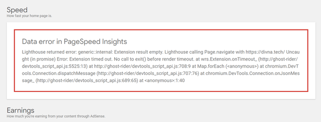

    @divna Thanks for reporting. I am unable to replicate the same issue from my side, and performing an audit on your site using Chrome Dev Tools works fine (which also uses lighthouse technology, the same as PageSpeed Insights).
    Can you let me know if this issue is occurring each time you access the Site Kit dashboard or was is a once off issue?
    To resolve this issue please try disconnecting the PageSpeed insights module again before connecting again. You can attempt from a browser incognito also, in case you have any browser extensions interfering.

    @jamesosborne thank you.
    The issue occured every time I accessed the Site Kit dashboard.
    Today I was optimizung the data base and now it works correctly 🙂

    Plugin Support James Osborne
    (@jamesosborne)
    @divna Good to hear, thanks for the follow up. From further investigation I can see that such errors can be as a result of temporary server issues or connectivity problems.
    I will mark as resolved, if you encounter the same issues again feel free to report.
