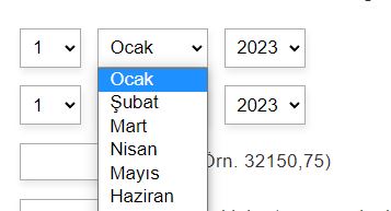

    3) Our last question is, is there a method to make the date field like this?
    Picture Sample

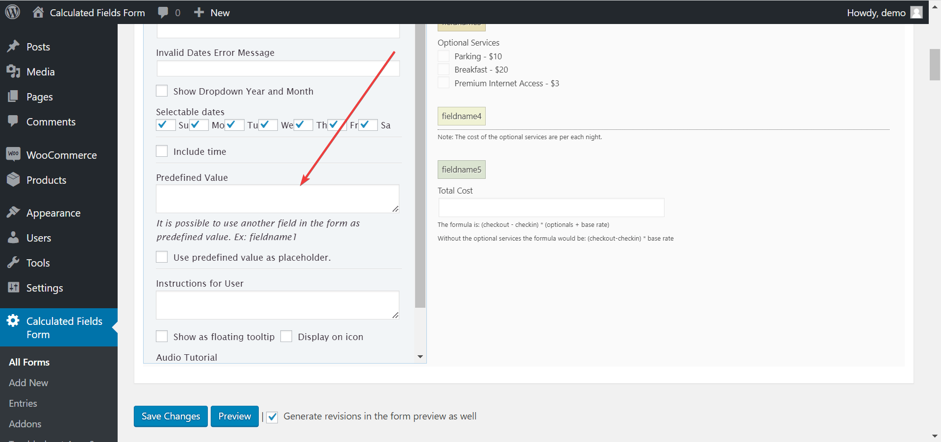

    Q: The date field is displayed to the user with the current date.
    Can we replace this with a custom date?
    A: Yes, of course, that’s possible. The Date fields include two attributes to enter the default date.
    “Default Date” allows you to enter a date directly with the same format selected via the “Date Format” attribute (Ex. 28/01/2023) or a relative date like X days, months, and years after or before today (Ex. +7m +1d).
    “Predefined Value” is similar to the previous one. It allows you to enter a date directly or a field’s name to display the date of another field.
    Another difference with the “Default Date” attribute is that you can use the “Predefined Value” to enter the field placeholder instead of the default value.
    If you want to display the field’s value empty, leave empty the “Predefined Value” attribute and tick the “Use predefined value as placeholder” checkbox.

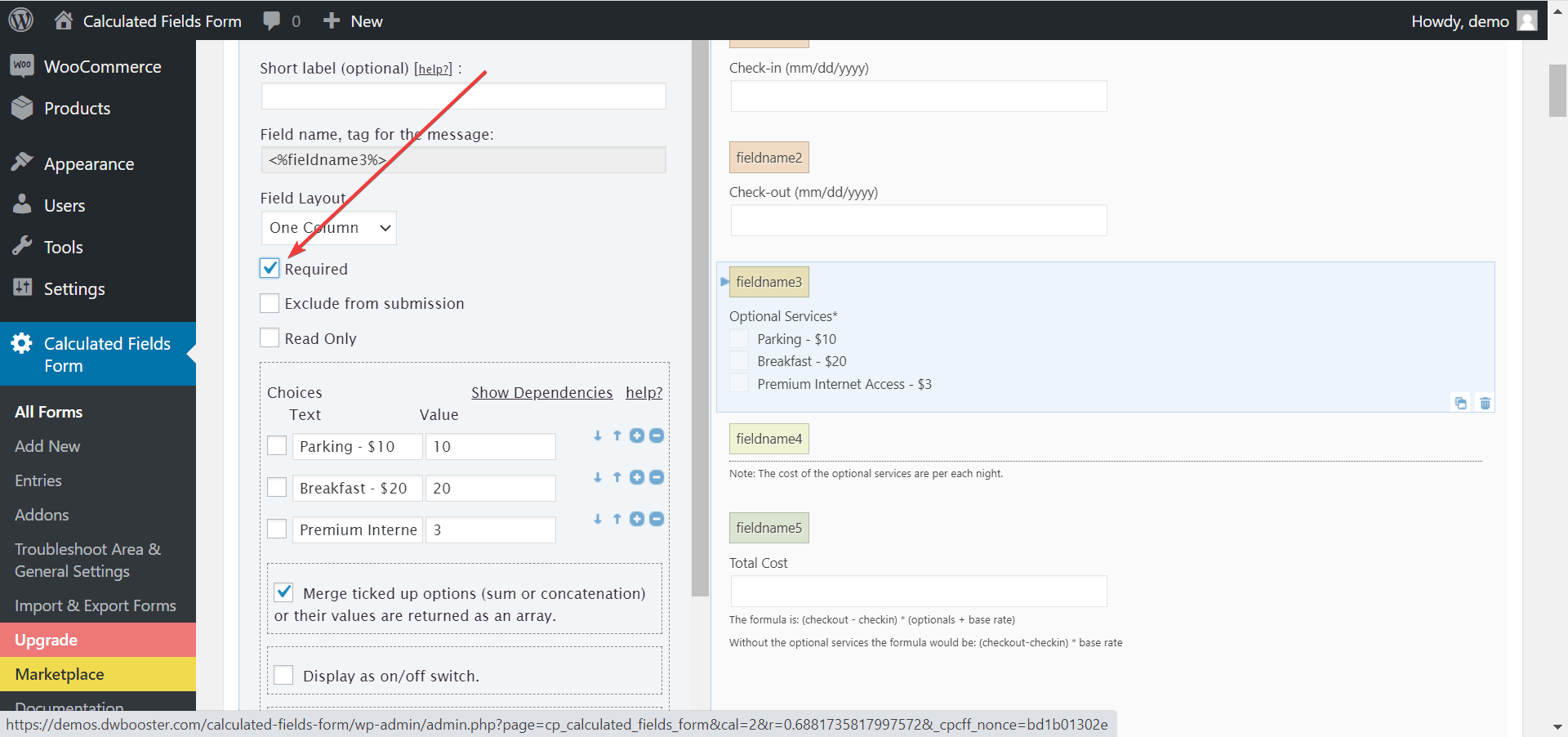

    Q: Where do we mark the required field that the user must fill?
    A: Tick the “Required” checkbox in the fields’ settings (The attribute is present in every entry field).
    Q: Our last question is, is there a method to make the date field like this?
    A: I’m sorry. You must emulate the date field with three separate controls.
    You can insert a DIV field in the form and select “3 Columns” through its settings. Insert three controls into the DIV field: A Number field configured to accept digits only, with the value 1, and 31 as the min and max attributes, a DropDown field for months with numbers as the choices’ values, and the months’ names as choices’ texts, and another number field for years.
    In this case, to use the date for calculation, you must concatenate the components:
