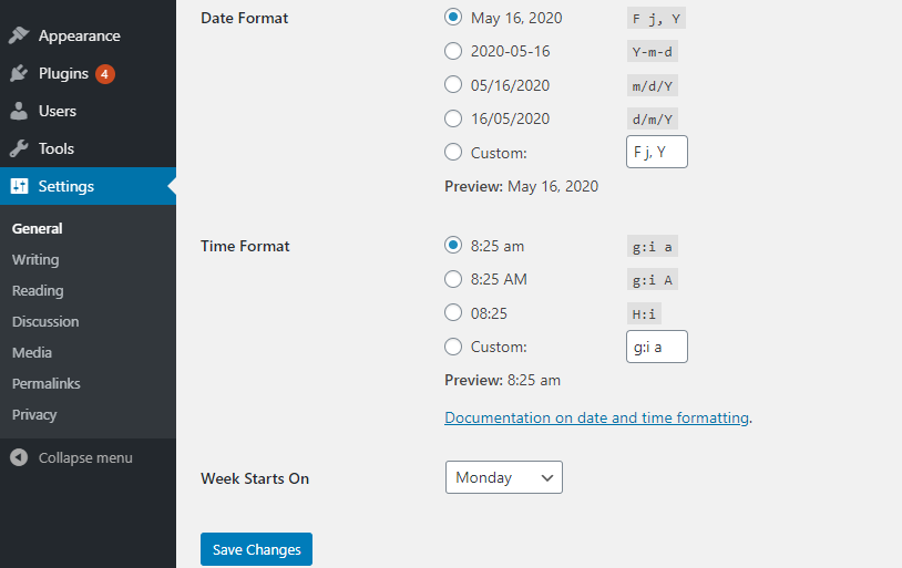

Please head over to WordPress Settings > General > Date / Time Format: https://i.postimg.cc/FF8LJnRt/image.pngBest Regards

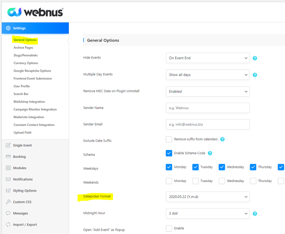

- To change the style of the datepicker, please head over to MEC Settings > General Options > Datepicker Format: https://i.postimg.cc/y8Myzjj6/image.png (back-end)

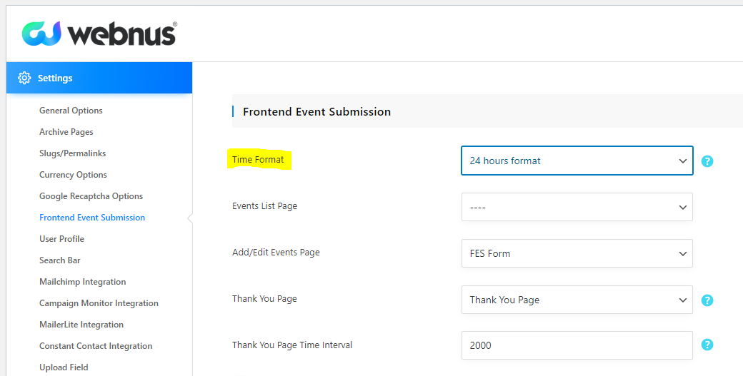

- To change the “Time Format” in backend and FES Form, please head over to MEC Settings > Frontend Event Submission > Time Fomrat: https://i.postimg.cc/Fsqjjp2b/image.png(back-end)

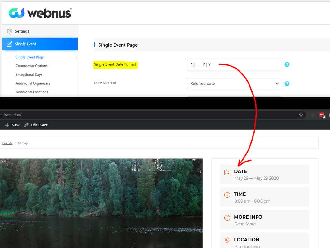

- To change the date format (just date) on the front-end of your single event please head over to MEC Settings > Single Event > Single Event Page > Single Event Date Format: https://i.postimg.cc/0yMhftr9/image.png

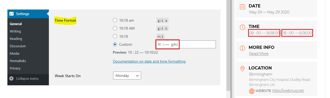

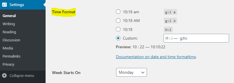

- To change the time format (just time) on the front-end of your single event please head over to WordPress Settings > General Settings > Time Format: https://i.postimg.cc/W3W7xvfC/image.png you can see all changes on the front-end of the single event page: https://i.postimg.cc/VkKBJ1z6/image.png

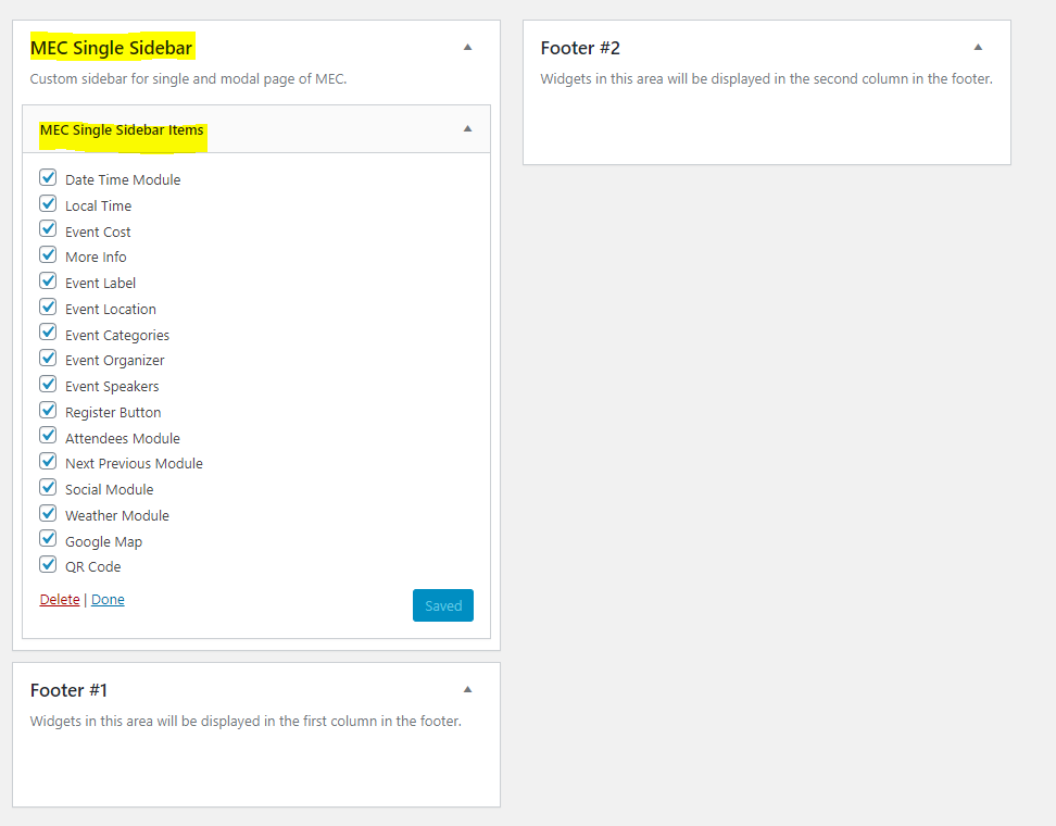

Also about the MEC sidebar, please note, this is not for another sidebar you should use the “MEC Single Sidebar Items” on “MEC single Sidebar”: https://i.postimg.cc/YC08fjng/image.png

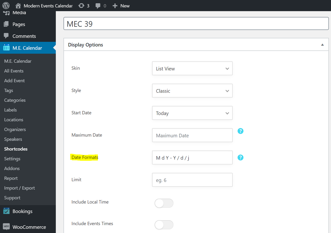

When you use the shortcodes you can change date format on shortcode settings:
https://i.postimg.cc/hvRGfrZn/image.pngPlease follow the steps explained in this article:
https://webnus.net/dox/modern-events-calendar/making-advance-shortcodes-in-modern-event-calendar/>> https://i.postimg.cc/G3PLXvSB/image.png
Best Regards
great that was the right advice. The hint to the shortcodes was it! I dont think, that this main (widget) element “upcoming events” would be a shortcode. Now it works and I’m happy. Thanks for support.
