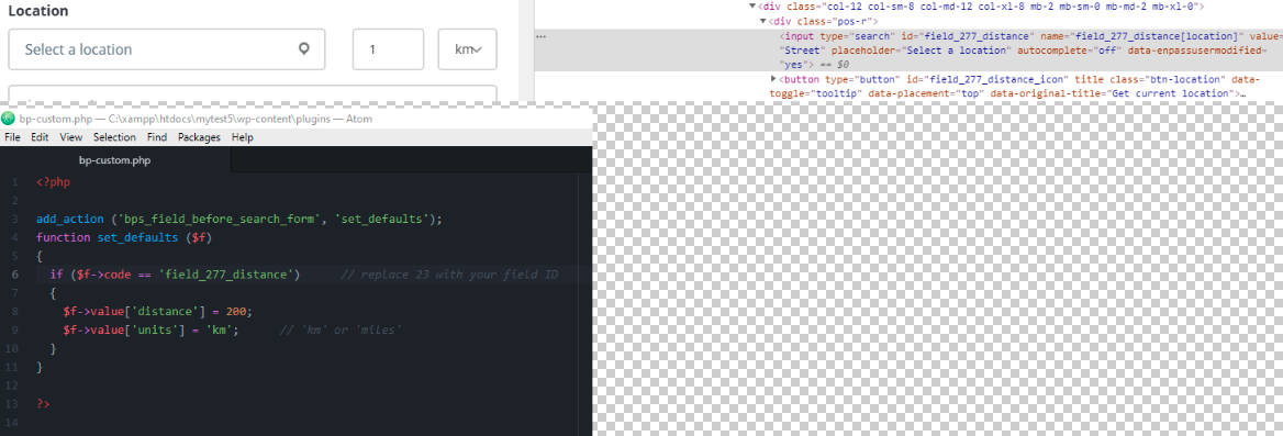

    Thank you Andrea, but at least for me isn’t working (or I’m doing something wrong).
    I tried to replace ‘field_23’ for my field ID (‘field_277’ and also ‘field_277_distance’ and ‘field_277_distance[distance]’). and any of them worked. I tried to add to bp-custom.php and also I tried the same removing that and adding to my theme functions.php and I still don’t see any difference. I keep seeing “1” in distance by default.
    I removed cache after any change.
    p.s. I attach you an screenshot to show you what I added: https://i.gyazo.com/1360a8123b7af779d6dbb17778cc5bf7.png
    Thanks a lot!
    Plugin Author Andrea Tarantini
    (@dontdream)
    The correct choice is field_277 replacing field_23.
    If that doesn’t work, could you please specify BuddyPress version, active theme, location plugin used, BP Profile Search version, and form template? Also, copy and paste the template information from Users -> Profile Search, column Template.
    Thread Starter imborx
    (@imborx)
    Nevermind @dontdream
    My bad, tt worked perfectly. It seems to be an issue with my current logged in sesion
    Thanks a lot 🙂
