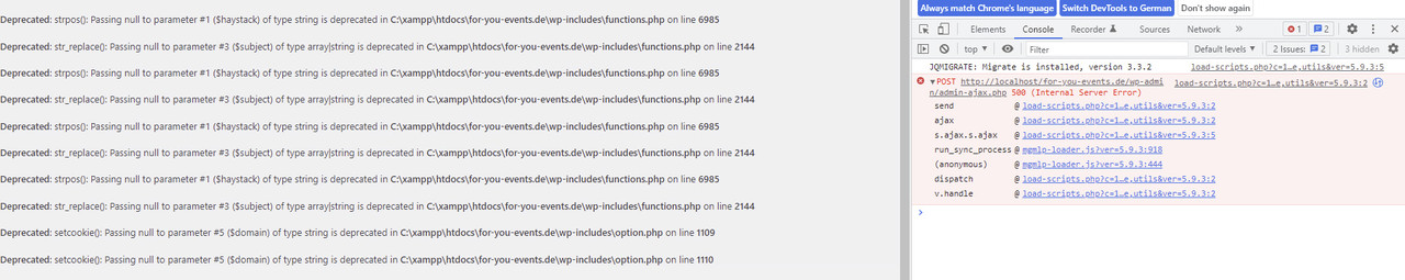

    Trying to sync the content of a folder in Media Library Folders (MLF) plugin failed with a POST 500 error: internal server error.
    This might be due to faults in the Xampp config, but after enabling debug mode in wordpress I got some more details. According to this MLF is using deprecated commands (see screenshot above).
    Debug and Console Errors
    Do you think this might be the reason for the failed sync process?
    I didn’t face any other issues so far.
    I could switch to an older PHP version as a workaround, but would be interested to know the reason behind my issue.

    Thanks for pointing out the issue. I’ll have to try syncing while running PHP 8.
    According to this page, https://make.ww.wp.xz.cn/core/handbook/references/php-compatibility-and-wordpress-versions/, WordPress itself does not yet fully support PHP 8. And that would also apply to a lot of themes and plugins.
    As for the debug error messages, stack tracing need to be turned on in order to see which file and the line number where these issues are occurring in the plugin.
