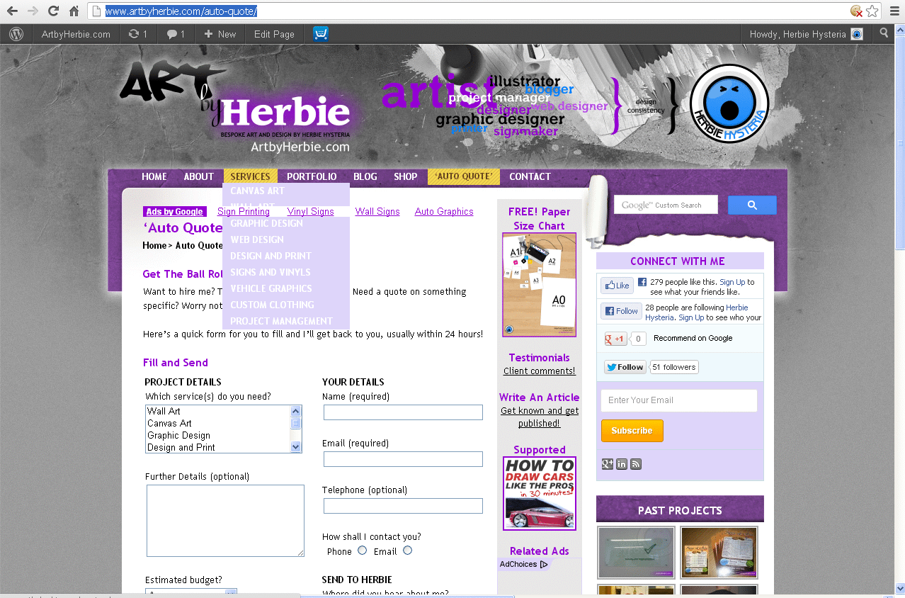

    also andrew, if you go to another page apart from the home page, i have google ads running across the top of the content, the menu li items appear BEHIND these google ads and not infront?

    any other page apart from ‘home’, ‘anout’, ‘blog’, ‘sjop’ etc, the google ads run at the top of the page
    Thread Starter Johnny Bravo
    (@herbiehysteria)
    see here: http://www.artbyherbie.com/auto-quote/
    the menu items appear behind the google ads
    (@herbiehysteria)
    am using chrome 27, latest version. here is what i mean: http://www.artbyherbie.com/wp-content/uploads/2012/12/tempmenupic.png
    Andrew Nevins
    (@anevins)
    WCLDN 2018 Contributor | Volunteer support
    Try adding these CSS styles;
    .menu,
    .center_content_bottom,
    #content-page {
     position: relative;
    .menu {
     z-index: 1;
    (@herbiehysteria)
    THANK YOU, ANDREW! works like a charm, i cant thank you enough brother, this has had me pulling hair out for three days now, i’ll just go ahead and add a small border to the menu items, looks ace!!! :))))
