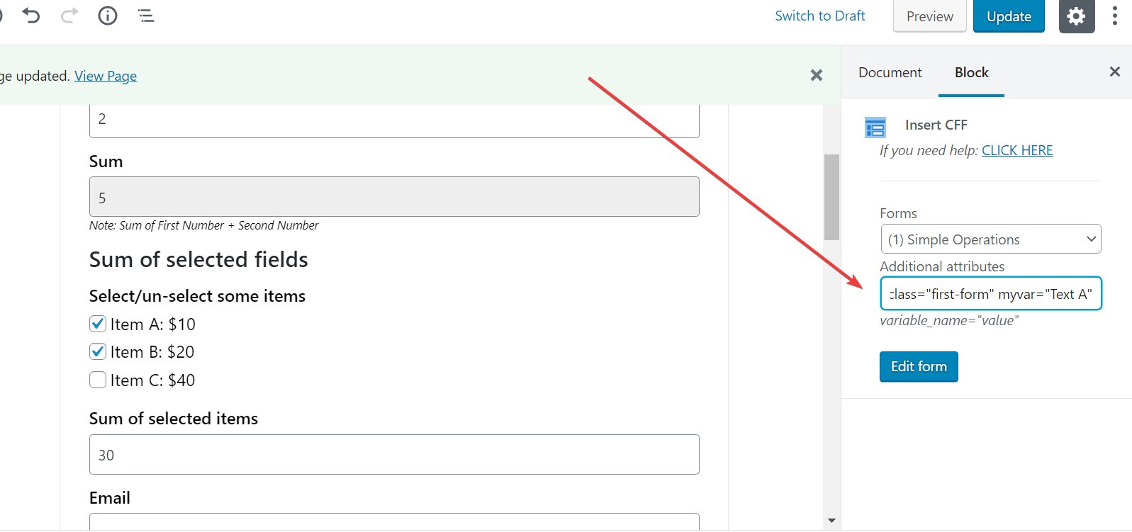

    There is a more elegant method.
    You can assign class names to the forms via their shortcode codes:
    [CP_CALCULATED_FIELDS id="1" class="first-form" myvar="Text A"]
    Or visually:
    And then, you can enter the following piece of code in the content of the HTML Content field
    <script>fbuilderjQuery(document).one('showHideDepEvent', function(){
    if(typeof myvar != 'undefined') getField('fieldname1', '.first-form').setVal(myvar);
    </script>
    If you assign the second-form class name to the second form, you can insert an HTML Content field on it with the code:
    if(typeof myvar2 != 'undefined') getField('fieldname5', '.second-form').setVal(myvar2);
    </script>
    Best regards.
