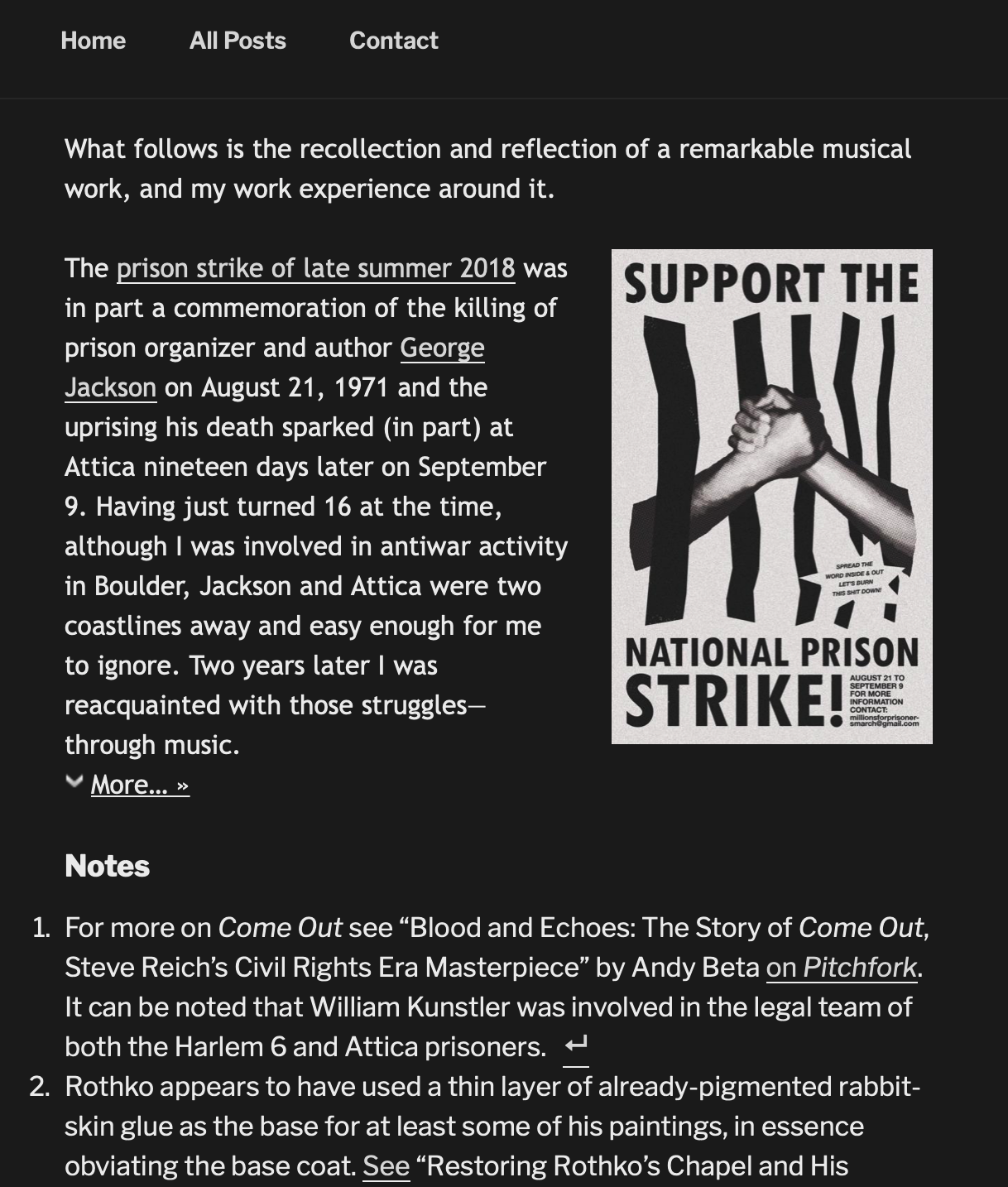

    The expand/collapse works well. It’s just that the footnotes for the collapsed content continue to display below the collapsed content, rather than be collapsed themselves.
    It’s as if the footnotes were posted outside of (below) the [/expand] shortcode tag. But the Easy Footnotes shortcode tags, [note]dummy text[/note], are embedded inside the content.

    Ok, we now understand the issue. The actual footnotes are tacked on to the end (or foot) of the page content. These footnotes are what you want to have hidden in a collapse element, however by the very nature of footnotes, they are not part of the main content.
    You might want to reach out to the Easy Footnotes plugin developers and see if they have a filter or a way that custom id or classes can be assigned to the footnote section.

    In the meantime we have modified the easy footnotes plugin to allow before and after content filters for the footnotes.
    The modified plugin can be downloaded from GitHub at:
    https://github.com/baden03/easy-footnotes
    once installed, add the following to your child-theme’s function.php file:
    add_filter( 'before_footnote', 'pre_footnote', 1);
    function pre_footnote($footnote_content) {
    	$footnote_content .= '[expand title="Show Footnotes" swaptitle="Hide Footnotes"]';
    	return $footnote_content;
    add_filter( 'after_footnote', 'post_footnote', 1 );
    function post_footnote($footnote_content) {
    	$footnote_content .= '[/expand]';
    A demo can be seen here: https://spacedonkey.de/3320/collapse-o-matic-and-easy-footnotes-test/
