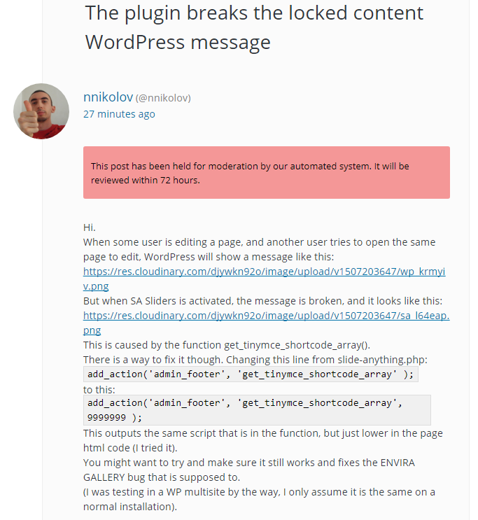

OK, here is the other problem: https://ww.wp.xz.cn/support/topic/the-plugin-breaks-the-locked-content-wordpress-message/
Please fix both, thanks!
EDIT: Argg.. They held my post for moderation after my last edit. Who approves those? I hope it is you.
I don’t know if you can read my new post held for moderation, so here is a screenshot of it: https://res.cloudinary.com/djywkn92o/image/upload/v1507206043/sa-post_kn9kub.png
